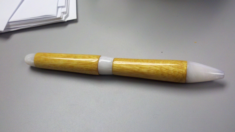

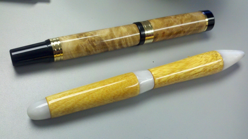

Made my first nib and finial last night. I do not yet own a chuck, so the nib was done on centers. The finial I glued to a waste block that screwed into a faceplate. The problem with this is you cannot remove the finial to check the size compared to your blank, and the tenon that needs to fit in the brass. This means you have to eyeball it, and I got pretty lucky.
I probably wont try again until I buy a chuck.
Osage orange and white pearl acrylic "hardware". Used tranny and tubes from a Slimline.
Kinda looks like a 50/50 bar. I put it next to an El Grande for size comparison.
