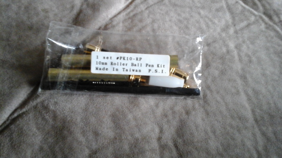

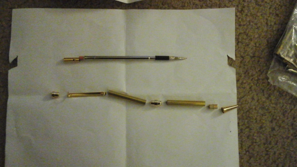

Here's a few pics. I plan to use these kits to practice and develope the skills needed to make some nice pens without spending a lot of money.

The first two pictures obviously go together ... you could start with that pencil kit; at least you have printed instructions.
The third pic is clearly a PSI kit ... a very old one ... from before my time.
If you would display the contents *out* of the bag there would be a better opportunity to see what it is. That "tubes and bushings" file I attached in my earlier reply might have some relevant information.
Google brought up this: http://www.pennstateind.com/library/PK10-FP_ins.pdf
which seems to be a predecessor of this current model: http://www.pennstateind.com/store/PK10-RP2.html

PK10 RP is very straight-forward.
10mm hole, insert tubes.
both ends are the same diameter, the couplers are interchangeable for the body.
Looks like the "snap cap" version. That is the only "tricky" adjustment. The top of that plastic piece screws onto the small screw that comes out of the cap piece. You can use a large phillips screwdriver to screw the plastic piece on, then adjust how far you tighten it down, based on where the nib "clicks on" fairly tight.
Good Luck, not difficult,
