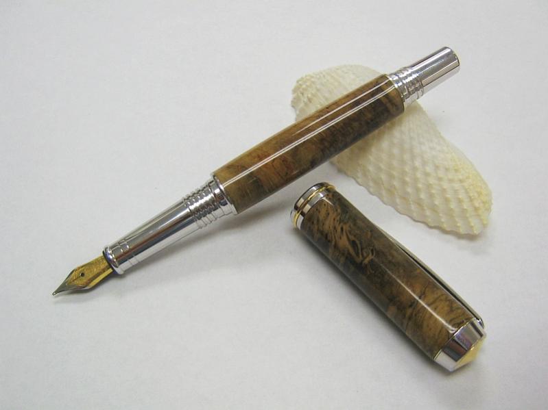

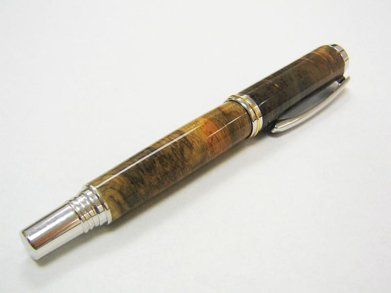

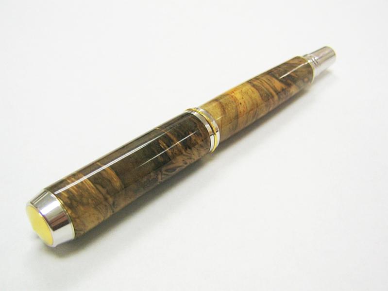

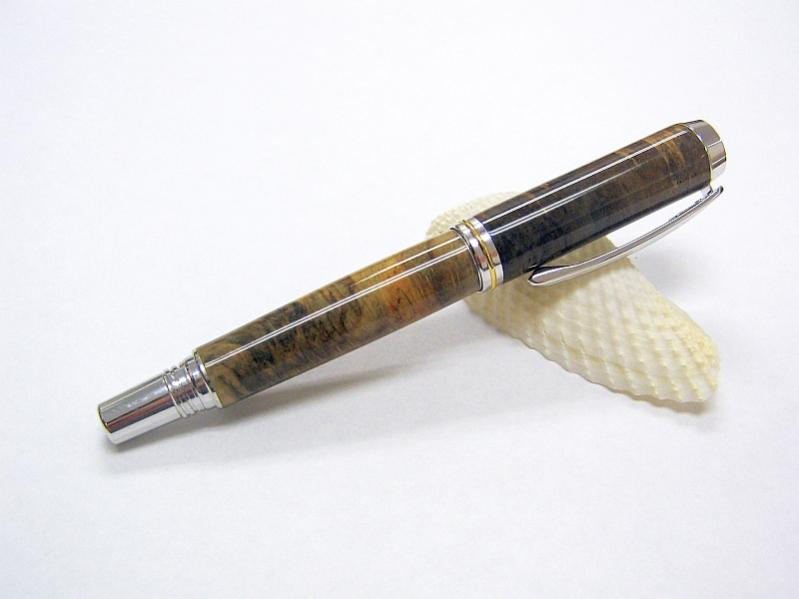

Well here are the results.
Sorry the pix are so dark. I took them under the office florescent lights, and then corrected with Irfanview.
