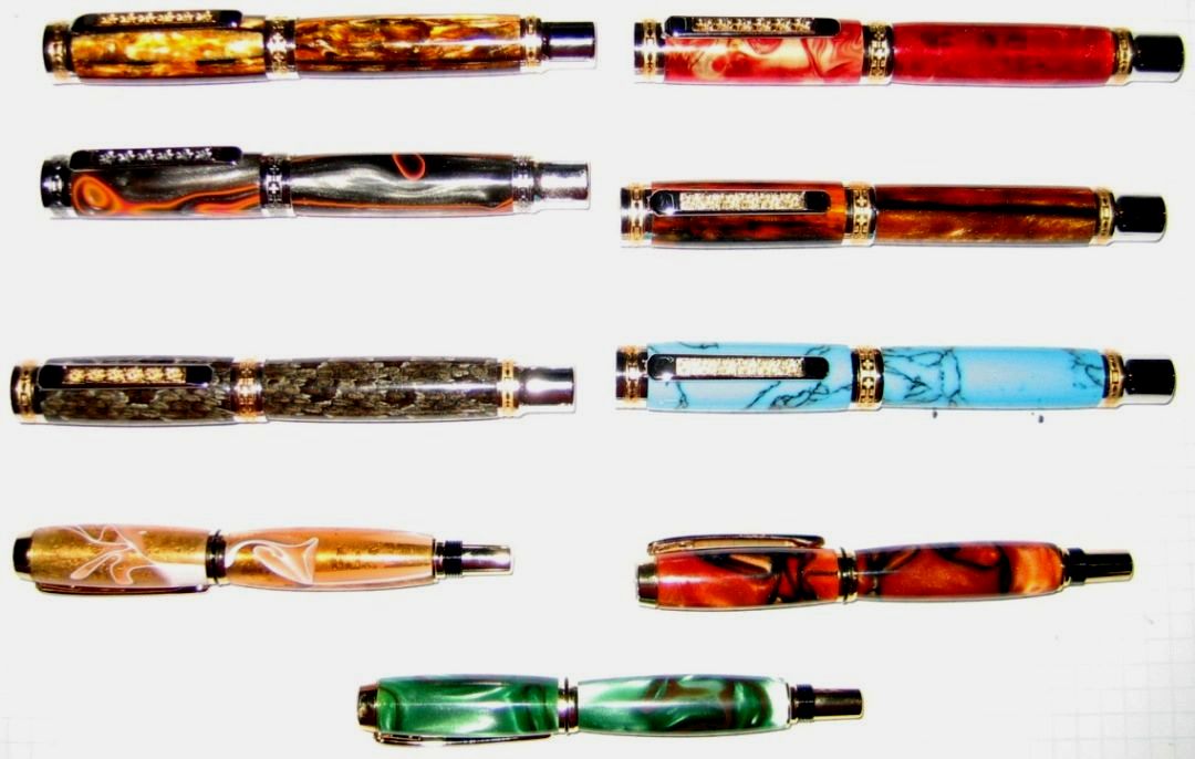

Every pen I did today was an alternatate material and required the usual sanding/finishing tapdance (not pretty I assure you) PR Snake, Celluloid, Tru-Stone and thanks to this board, Lucite.
I go 120, 220,400 grit, red fiber pad, grey fiber pad, 0000 steel wool, then 1500, 1800, 2400, 3200, 3600, 4000, 6000, 8000, 12000 Micro Mesh, two coats of Hut crystal and two of Ren wax... that is all. Oh yeah and I also turn them.
I am getting fast however, the Tru-stone set a personal record. From square to off the lathe and ready to assemble in 9 minutes 12 seconds.

I never get drips on my lathe bed. I fold up a piece of Viva paper towel to about 2x3, put some MS on it and hold it against the backside of the blank while holding the MM pad against the front. No drips, ever. The pens looks nice, but the picture is over-exposed.

My primary material are acrylics. Each pen take me about 1/2 hour to and hour from start to finish. I use to complete them alot sooner but was unhappy with the finish.
I wet sand to 12000.
I put a board on my bed so that it does not rust.
After I am happy with my turning.
I slow the speed down to the lowest it will going and begin sanding at 800-1200 mm wet sand though 6000 mm.
After that I turn the speed up to 1300+rpm and polish with the remaining mm to 12000.
Then a final go over with scratch remover
Then Ren wax.
Been real happy with the results.
When I first started making pens I though I had to do one every 15 mintues. When I slowed it down I was able to charge more for my pens.
By the way your pens do look good.

Not trying to discount you or anything, but I cant get the blank drilled and glued in 9 and 1/2 minutes let alone turned, finished and assembled. I guess I just take longer.

The drilling, tubing and pen milling were done already. That usually takes me 4-5 minutes a pen. I have several cutting jigs and two drill presses with both sized bits all ready to go, I do this full time so I have lots of built in justification for extra tools.
I often muse to myself about how little time in penmaking is actually in the turning.
By the way fast doesn't mean poorly done. I don't stop when a buzzer goes off, I stop when there are no visible scratch marks of any kind and the finish looks as close to perfect as hand made can accomplish. I sell my Emperors in the $230-$300 range usually 2-4 a weekend.

BTW, I keep my lathe ways dry when wet sanding by covering them with a plastic trash bag. Sopping wet and still no rust on my lathe. Your MPG may vary.

I am considering painting them but hadn't come up with a color that wouldn't detract from the material as much as it added. The glue bubbles look kinda cool, I am calling the pen vanilla coke, which explains the bubbles.
