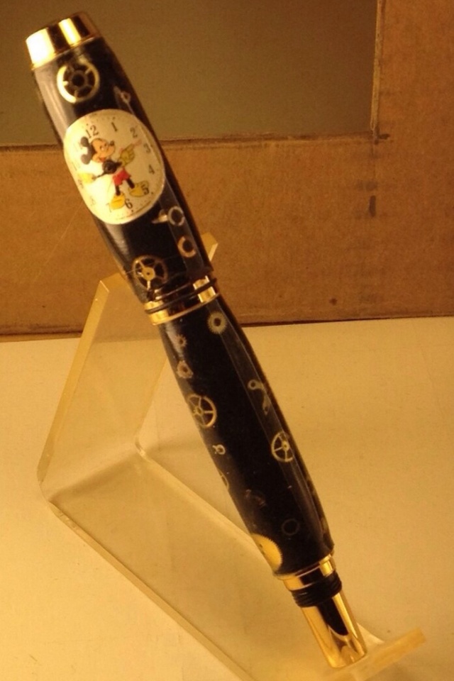

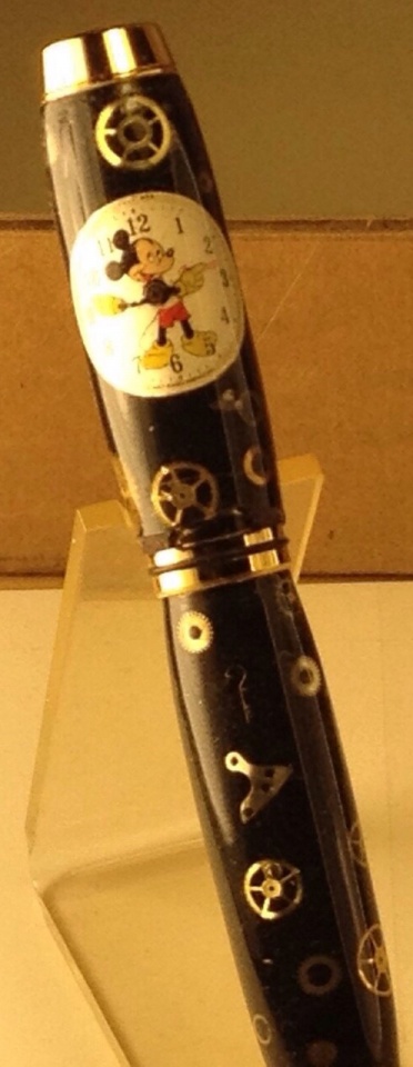

Well this is my second attempt at casting a watch part pen. The Pen is a Jr Gent 1 ( I like that style of pen) Tube painted black and it is cast in Alumilite clear. sanded to 24mm. 2 coats of thin CA and 10 coats of med. CA. Polished with plastix. As always all comments are welcome and thanks for looking.

Nice Pen Jerald,
Great Fit and Finish.
Though the photographs and lighting could be improved,
The First Photograph, is slightly out of focus, while the side lighting on the second has washed out the side of the dial.
IMHO, I would like to have seen some more watch parts included in the cast, so that I was to pick it up, it would hold my interest a little longer.
