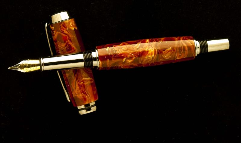

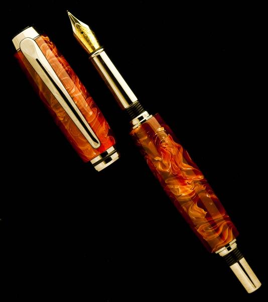

Made it this morning. The blank is from Dawn and Ed at Exotic Blanks. It's Mexican Agate on a Black Titanium Navigator Fountain Pen. Have to use really sharp tools! I really like this blank.It is beautiful. I tried different exposures to give an idea of the depth to the blank. Not sure if you can tell. Sanded from 150 to 600 grit, MM (wet) from 1200 to 12000 and finished with HUT Plastic Polish and Ren wax. I hope everyone has a great weekend. Thank you for taking the time to look! Doc:)

Great job on the pen. I also like the photography. What did you use for the black background; any special setting on the camera or lighting to make it come out that sharp?

Super job on both the pen itself and your photography which captures the qualities of the Mexican agate. What color did you use to paint the blank or tube to yield that great appearance. The swirls in the agate really stand out.

I used a light box with black velvet background. Used a Nikon Digital Macro 60 mm Lens with a tripod and remote shutter release that helped minimize vibration and increase sharpness. Changed the position of the flood lights to vary the exposure. Hope that's helpful. Doc

I didn't paint the tubes. I used the dark nickel plated replacement tubes that are available for the Navigator pen at Woodcraft.

Does look real cool. Did you get the blank from Ed???
Is it that transparent that it needs a painted tube???
One other question: you say you use black felt in the light tent, I think you owe it to us all to tell us how you keep it dust free??? There is not a speck of dust in the photos unless you doc:) the photos????

Got the blank from Ed and Dawn at Exotics.
I'm not sure that the blank is that transparent but I didn't want to have to deal with the sickening feeling of brass showing through.
How do I keep from a speck of dust in the photos? Only if you promise not to laugh.......I use my wife's Evercare Giant Lint Roller (Adhesive) on the surface of the velvet right before I place the pen on it to take the picture:rolleyes:. That gets rid of 99% of any visible dust. If I still see any dust, I use the spot removal tool in Adobe Bridge.

I've already gotten a PM asking the same question. My best guess is that it is a very hard dense brittle resin. It is definitely brittle when turning and I used fresh carbide cutters after the first minute or so. It does not have the opaque properties that I have noted with Tru-Stone where you less likely to need painted tubes. Rather the material seems transparent enough to see the various layer swirls and multiple variety of hues that you would expect from a polymer resin or plastic. That's my two cents worth.
