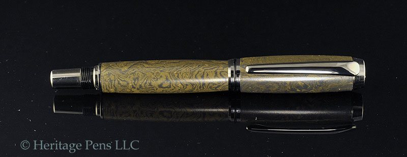

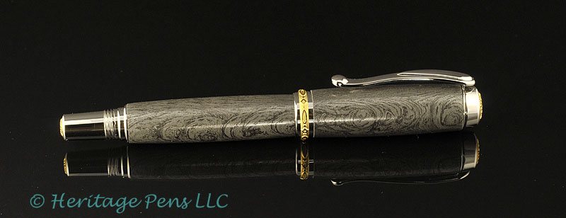

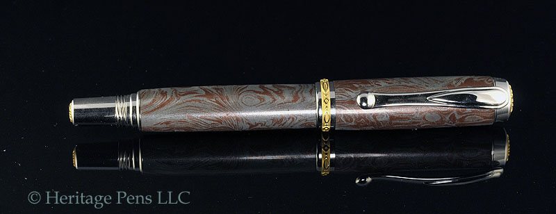

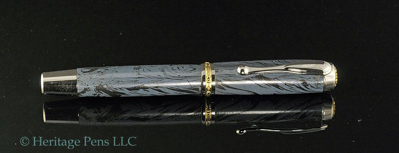

Here are some pens I have made using these blanks.
The blanks make very heavy pens.
