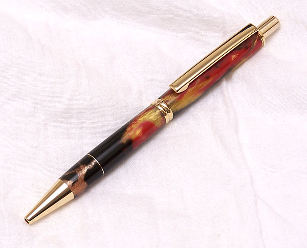

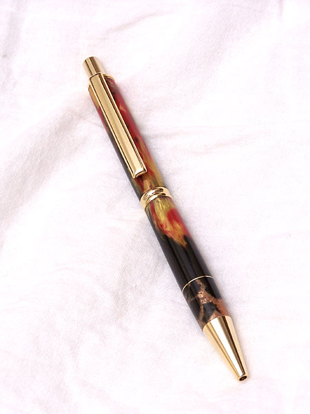

For your first attempt try adding a brass or aluminum line. Get your blank turned then part off a chunk of the existing blank. Cut a piece of brass or aluminum and drill it for your tube. Cut a piece of wood or resin (same or contrasting) and drill it as well. Then glue the metal on, followed by the wood or resin, and put it in a vise or clamp to hold it tight while the glue cures.
Then you can experience turning the metal turning on the pen's axis which is much easier than when it's at an angle for knots or other segmenting.
That's how I did this silly thing:
