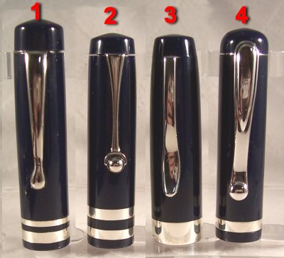

I have used silver washers for accent bands, silver tubes for center bands as well as accent bands. You can purchase all the silver you would need from: http://www.metalliferous.com/silver.php
I have also fabricated bands from PMC silver with good results.

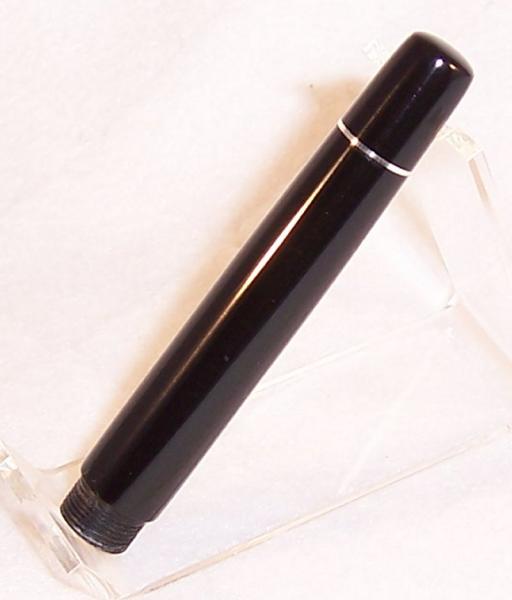

The first photo below shows four caps, numbers 1, 2, and 4 are fine silver tubing that was swedged into very thin grooves cut into the cap. Number 3 is PMC silver. The second photo shows a silver accent ring made from a fine silver washer.
