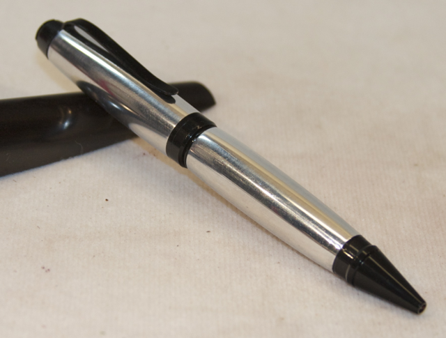

Hi,
I had my learning experience on an aluminum cigar pen recently and wonder what other soft metals are being used.
Does anyone have a listing of what drill sizes to use on the solid metal blanks. It took a few tries to get the right size hole before things worked.
Bye for now,

Brass is one of the other common metals used but it is not as common as aluminum. Several make pens from stainless steel and a paltry few from titanium. The drills sizes for the inside are hard to standardize as different manufacturers of like kits use different Inside diameters for the parts.

Drill bits will not give you an accurate diameter due to wear and tear and the rough finish a drilled hole will have internally . This is what reamers are for. The hole is drilled slightly smaller than needed then reamed to diameter which gives accurate results.
I am presuming you are asking as you want to push fit the components into the aluminium. As mentioned extra tooling would be needed, but personally I would recommend measuring the outside diameter of a brass tube and drilling your blank to suit. Glue the brass tube in like you would with wood.
