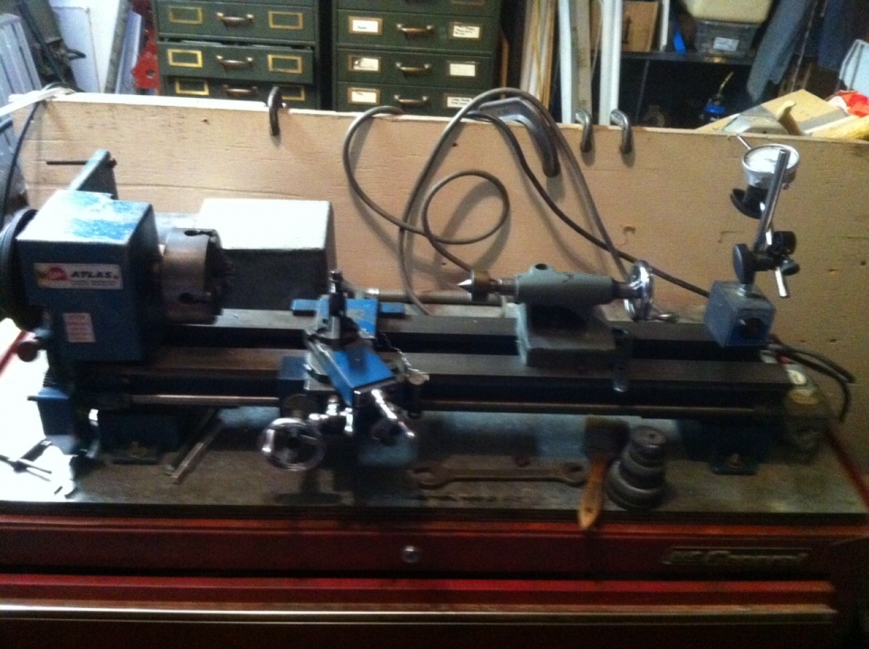

There is a learning curve. obviously. I have had the HF style lathes, and they will do what most want done with them. I came across a 6" Atlas lathe a bit ago. Nothing fancy, but a 6" swing, and about 24" between centers. Threading is by changing gears, same as most mini lathes, so nothing lost or gained there. Fun little machine for what I have done on it so far. Blurry pic, but here it is.

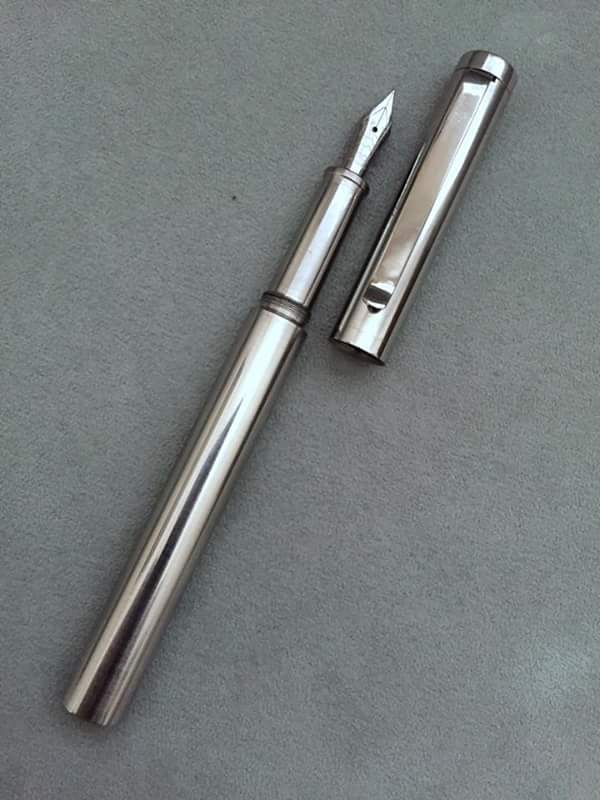

I've had a HF 7 x 10 mini lathe for about 6 months. Paid $405 with a 25% off coupon. I've probably spent close to $400 on tooling and extras. Little Machine Shop has lots of stuff tailored for the mini lathes and good advice also. I've used mine to make taps and cut external threads. I am converting to dies this week. I have been making kitless all metal pens not possible on a wood lathe. With some tweeking it has been suprizingly accurate. I took a machining class in college 25 years ago and remembered most of what I needed. I would recommend a class or finding someone near that will show you the basics.
Stainless Steel Fountain Pen below.
