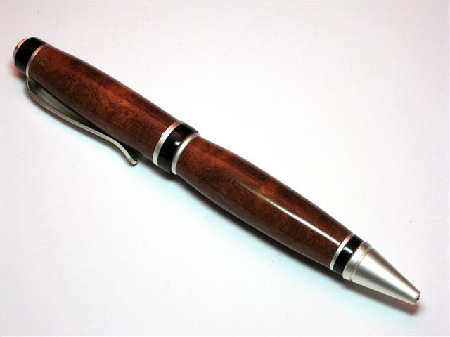

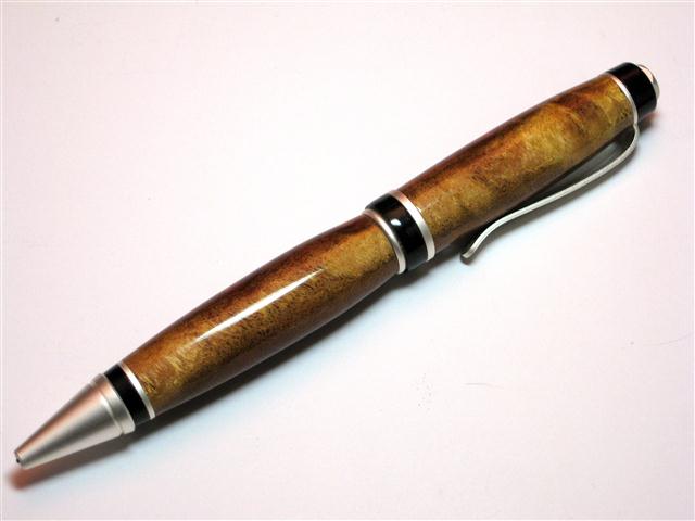

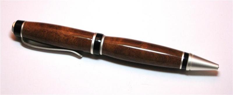

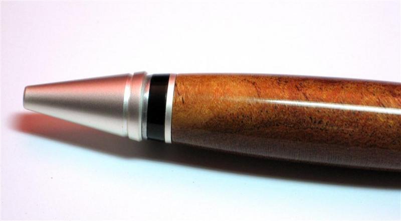

Ok, so I had to hand cut the tubes on this one and cut them to the exact specs from the library. However either I nicked the tube down when I was squaring up or this particular kit is a bit off. Once finished up, the tip of the refill peeks out of the tip slightly and extends too far when in the open position.
Is there any way to shim up the transmission or tip that won't be obvious when it's assembled?

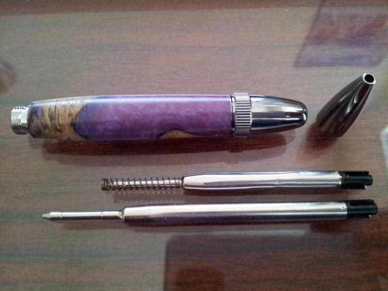

Pull the black refill stopper and trim the refill downa bit. This in turn will pull it back up into the nib enough the when retracted all the way it will not poke out.

here is a pick of my stubby Polaris I did for my 10 yr old. you can see the shortened refill. Hope this helps
Wasn't aware you could do that. It might get me just enough to at least have it retract all the way.
I guess I could just do that and keep it in my daily writers collection. If I cut it down and sell it, the first time someone goes to replace the cartridge, the issue will return.
I know there is a perfect tube length tutorial in the library, but I was a bonehead and skipped checking before gluing it up. Chalk it up to another lesson learned.
Thanks!

Looking at it, what I may do is turn a fatter black trim ring at the tip and just lengthen the tip a bit. Should get me enough to be comfortable with.
Lenny
Jan 6, 2009
3,475
Searsport, Maine
That's what I was going to suggest but you figured it out on your own!
That's really a better solution if the pen is going to end up in someone else's hand.

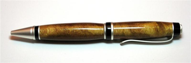

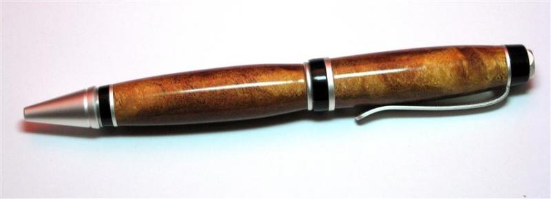

I just turned down a small aluminum trim ring to sit between the black trim ring and the tip. Worked like a charm. Left it with a brushed (sanded) finish as it was as close as I could get to the satin color of the kit. It's noticeable but doesn't stand terribly.
Thanks for the pointers all. Good to know about the refills for some one-offs.
