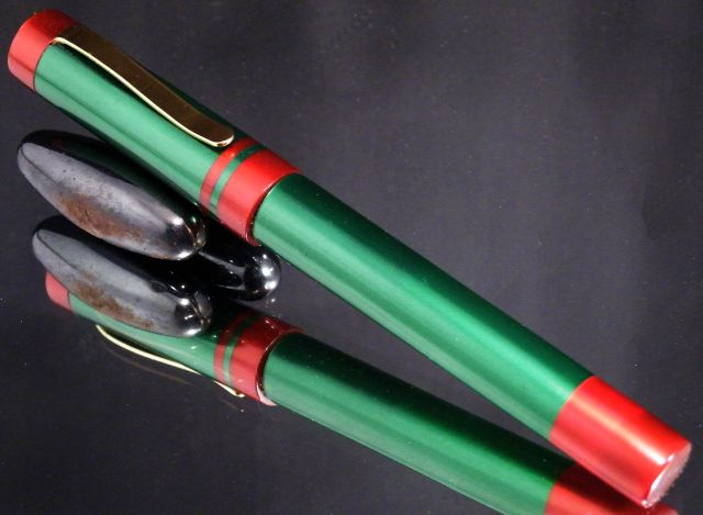

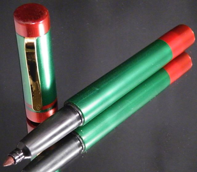

I made this pen just for fun , my new daily marker :biggrin:

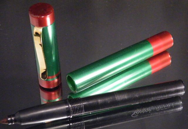

This is a Christmas colored Marking pen . It uses the Sharpie marker refill . The body is made from the Metallic Red and Green blanks from Dawn and Ed at www.exoticblanks.com , these blanks are really cool . They are very metallic looking , like the metallic red and green garland that you put on your Christmas tree , the pictures don't show the metallic sheen these blanks have .

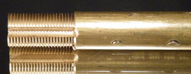

I made the tap to thread the barrel to accept the sharpie refill out of some brass stock (I don't have any tool steel right now , I will be ordering some soon) , it works very well on acrylics but is too soft to do metal so no couplers for wood at this time .... but soon .

I've been learning to use the metal lathe and have now made several different sized taps for the different sections I've been playing with . Most of them are brass because it is what I have here on hand . The brass works great for acrylics and tru-stone .
Bruce , I used a cigar clip recessed into the cap and the finial screws on and holds it in place .
Rick , the right tap is a .450X26 , see this thread http://www.penturners.org/forum/showthread.php?t=52672
