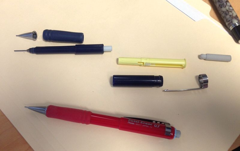

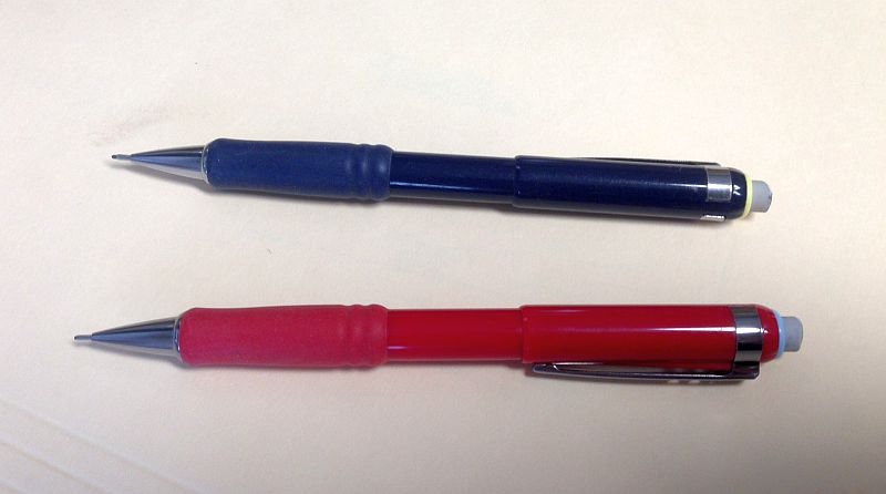

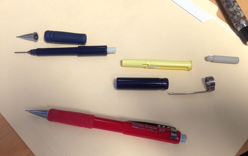

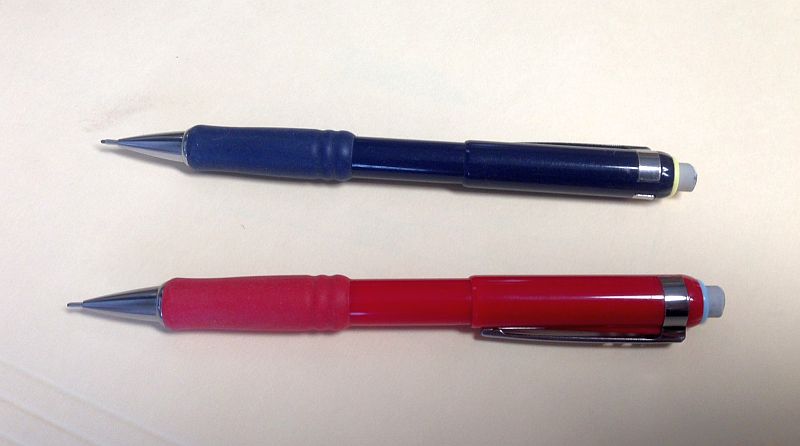

See attached photos.
One shows the pencil mostly disassembled.
I think the collet/lead advance mechanism must be molded into the plastic barrel because I don't see a way to remove it.
Model numbers QE17 (.7mm) and QE19 (.9mm)
I just bought two pack from Office Depot/Office Max.
I'm thinking that I'll just remove the clip and turn off the block that keeps it from rotating, then turn a body to fit over both barrels, glue 'em on, and call it done.
Any feedback and suggestions welcome.

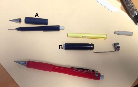

I could replace part A, but part B would have to be machined on the inside to make the twist erase mechanism work. It is threaded on the inside.
Any idea of the type of threads on the inside of part B? Is the brass looking thing what it scews onto? You might take the brass part to a real hardware store and see if nut will screw on tp those threads. Sometimes "close" will work, but unfortunately that is rare.
dogcatcher
Jul 4, 2007
2,361
TX, NM or on the road
Is part B thick enough that you could turn it down a little and use it like a brass tube inside of a wood barrel? I think that you would have to make the top barrel a little larger than it is now. But since it has the "skinny" middle already, I don't believe it would change the appearance very much.
