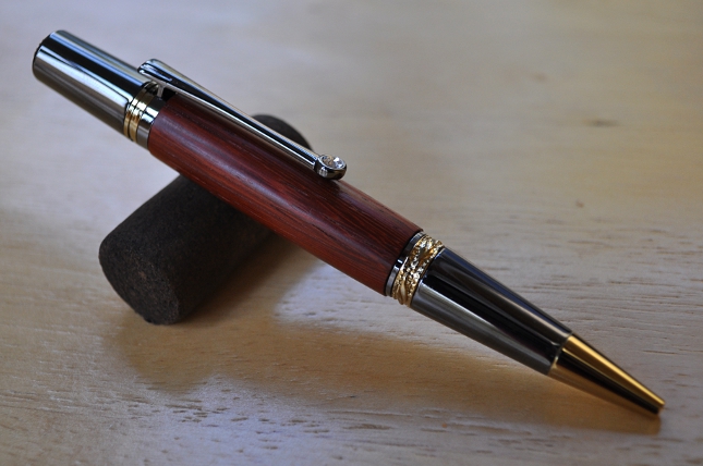

Closing the loop, as it were - - -
Here's a picture of the final product. Actually, the fourth and fifth attempts proved successful. No 5 was finished with CA and will be a Christmas gift for a family friend. Unfortunately, my wife grabbed it for wrapping before I could photograph it.
No 4 (where the padauk blank split) was glued back together with CA. The finished pen was finished with about eight coats of a lacquer-based friction finish. It's going to be a gift for my wife.

I like the pen a lot in the photo there. It might just be the shadows, but the end looks like it hangs over the band a little? I have to give it to you for hanging in so long. After the 2nd failure I would have for sure been done for the night after I kicked a few things.
