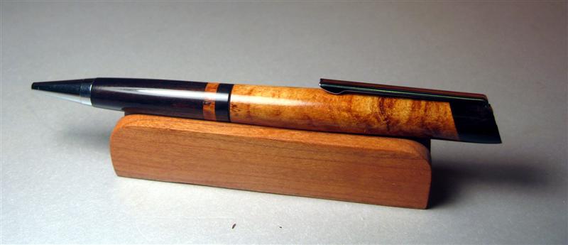

At last months Board meeting for Turners Anynonomous, one of the other board members was offering some blocks of maple burl that he had picked up. He was selling them for a buck each. (I didnt want to be a hog so I only took 10 or so, Now I wish I had gotten a few more
Maple Burl and blackwood chrome slimline, recessed clip, Ca/blo finish
Thanks for looking

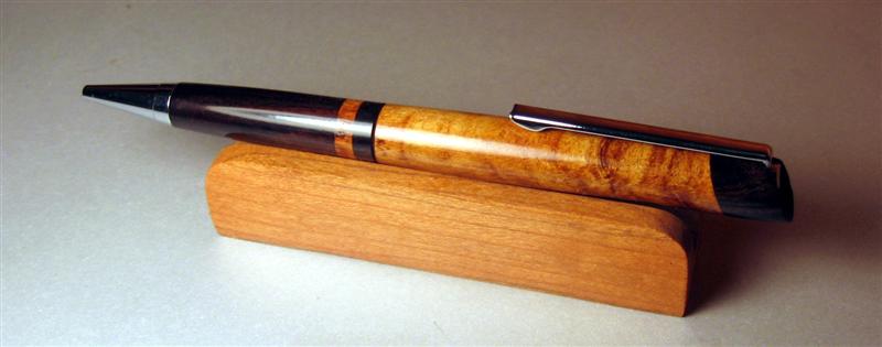

this one shows the clip end a little better

One of the best slimlines that I have seen, the photo is excellent as well!!
Could you share how you did the clip.

Now that's a great slimline, I've seen pics of one very similar to that. Goes to prove that there can be great pens made from slimline kits.:):):):):)
splinter99
Dec 31, 2005
924
Bunola, PA, USA.
Thank You Don, that is a very good article, that is excatly how I did it Nick. I had seen a pic of a pen made that way a while ago and just went to work figuring out how it was done..Wish I had seen Dons article, It would have saved alot of trial and error. (I also write an article called "penturners corner" for the clubs monthly newsletter)

Oh, BTW Harold, your pen is really nice. you did an excellent job with it. I like the little slice of maple between the blackwood bottom and the slice of blackwood... These pens are fun to make for a unique and different look. Slimlines are fun to modify.

I don't wish you'd gotten more....
I wish you'd gotten them all and sent them to me.
That wood is gorgeous. The pen looks great, nice find and nice work.

very nice pen! Great read on the article, looks like I now have something to try so I can finally use up the countless slimline kits I've never used. The slims have always been to boring for me. Now that's what I call creating excitment.
