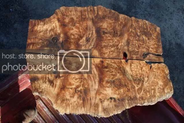

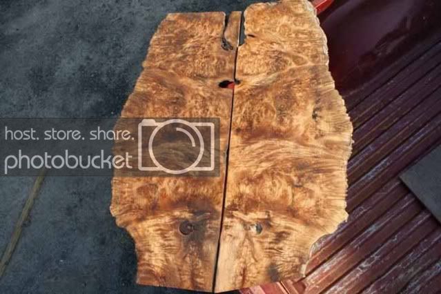

I finally sold enough wood so I could actually do some woodworking now. Here is what I have been working on lately, it is a maple burl table. I have a book match set but am only going to use one side for the table. The top is sanded and wiped down with watco oil. Any suggestions on a finish? I want it to be low build satin finish that is durable. I can't decide between wipe on poly or lacquer. Ideas and suggestions? Any one want to give it a nice CA finish?

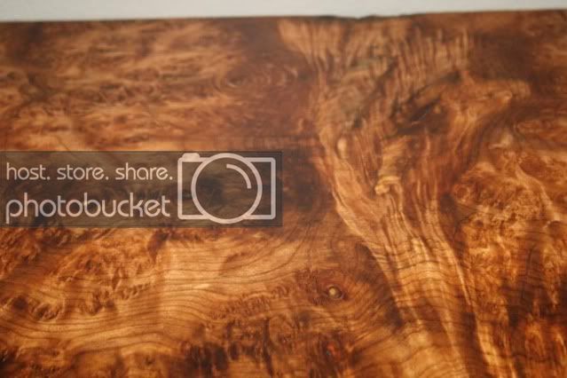

Thanks for the input. I went with a wipe on poly for durability. I also added a bow tie inlay in african blackwood to help old a loose part together. The finishing has taken a long time but is coming along. I hope to instal today so I can snap some pictures.

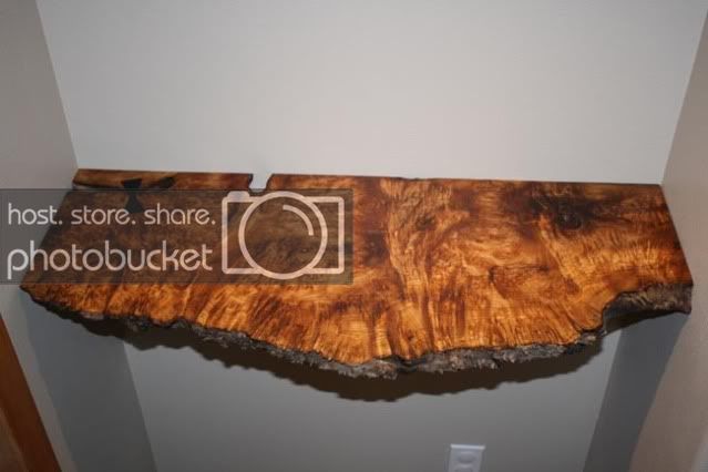

Finished product

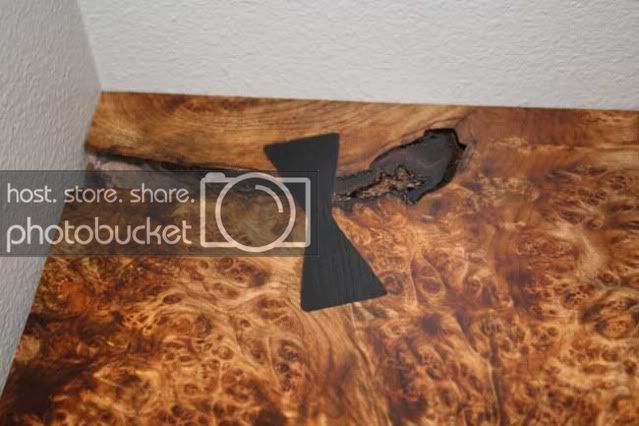

Here is the finished table for my wonderful wife installed. It was so much easier with a clean shop andsurface to work on. I inlayed a blackwood bowtie to strengthen a weak point. I tired to use a 1/8 router bit but it broke so I had to finish it by hand. It is finished with many coats of wiped on poly.
seamus7227
Mar 18, 2009
6,220
Wichita Falls, TX
without a doubt! SUPERB!!! the last person i saw do the bowtie technique was David Marks when he did that show "woodworks" on i think the D.I.Y. network. Very well done!
