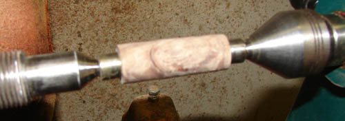

I see the post. I didn't save the photo but, if Jeff doesn't object, you can see the post at TPS. http://www.thepenshop.net/forum/forum_posts.asp?TID=5265&PN=1
Be sure to scroll down to my second photo for correct set-up. Not my idea originally but recently "discovered" by me as making ultimate good sense to do.

Originally posted by GreggR
<br />Oooh, I tried the posted link.... wouldn't let me in, said it was only for members! I hate it when that happens [:D]
Sorry, I didn't know it was set up that way. I'll try to capture the picture from TPS and show you here. Or, I'll take another shot later today.
OK, here is a picture. Sorry for bad quality, it was just a quickie but you can get the idea.
BTW, I read posts at TPS today without logging in. Dunno wassup.

Originally posted by saltwein
<br />How are the bushings aligned with the blank? Is there a small rod or just compression holding it together?
Regards, Steve
The alignment is the same as with a mandrel, the bushings are in the tube. The centers, ...uh...center naturaly on the bushings. It is now my preferred method of turning pens. No mandrel. No chatter.

Originally posted by Rifleman1776
<br />Sorry, I didn't know it was set up that way. I'll try to capture the picture from TPS and show you here. Or, I'll take another shot later today.
<br />
I learned this set up from Kiddo...been a proponent of it for a while but stopped.
I think using this method stresses the bearings of headstock and livecenter too much since you have to tighten the the tailstock so it won't slip. It does work great alignment wise but I wouldn't risk my lathe for it.

Frank,
As long as it works for you. I am just sharing my experience so others may decide better if it is for them or not. If it is, then atleast know what to watch out for.

Wonder of one of the machinist in the forum could make a Dead Center Drive with a no agressive drive feature, something that would have a small tooth to drive the bushing.

Hi All,
Yesterday I ordered a MT2 dead center and the popular MT2 live center from Little Machine Shop. Total cost was $28.66. I cannot wait to give this a try!
Thanks for sharing the idea!
