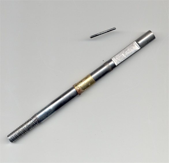

Originally posted by terrymiller
<br />Does anyone have any pics of the pin chuck.
vick
Nov 16, 2004
1,447
Gilbert, AZ, USA.
<b>Image Insert:</b><br />
<br />
This is a picture of a pin chuck I made. Since then I found someone that makes them for me pretty cheap and I have them made for me.
