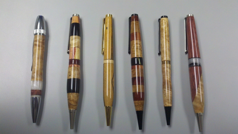

I never really gave this a thought, until I saw a post about it.
It is nice having the freedom to change the shape, since there is only the nib and cap/clip to worry about. It is also nice to be able to turn the center band along with the wood, ensuring that you will have a flush fit when you assemble the pen.
Here's a few, from left to right:
-Cabara hardware with maple burl, white pearl acrylic and purple heart bands
(The rest are all Slimline hardware with my own center bands)
-Tulipwood, ebony, maple burl, with purple heart center band
-Bocote with maple burl center band
-Oak and manzanita (both "homegrown") with black and yellow acrylic centerband
-Maple burl with bocote centerband
- Purple heart and maple burl cross cut and glued to be "straight" again, with purple heart on top and a white and black acrylic centerband
Let me know what you guys think. I've seen a lot of awesome pens here, and have thought of many ideas while reading these forums at work. Still trying to learn.

They all look very nice. Gotta try making my own center bands. I'm a "newbie" and still have a big learning curve to overcome.
Keep up the beautiful work.

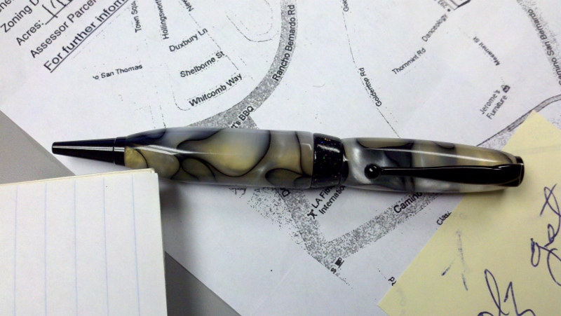

heres one i did last night, first one thats all plastic (acrylic or whatever it is). Still messing around with shapes, this one is almost like a reversed cigar.
Black and white acrylic with a black irredescent acrylic band

Looks like you have the centerbands pretty well figured out. With any of your plastics (acrylic, PR, Alumilite) you can skip the centerband entirely and just soften the edges at the center and REALLY play with some interesting shapes. It works with wood too, but it's tricky nailing the finish.
