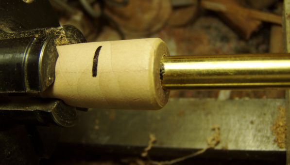

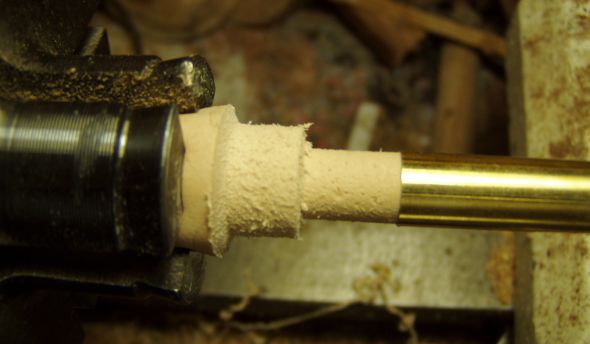

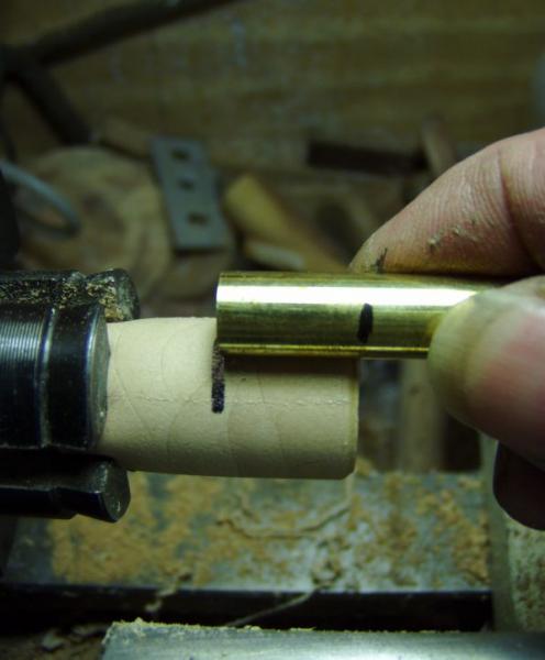

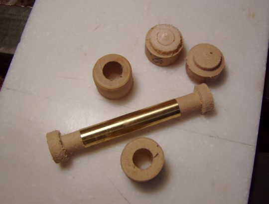

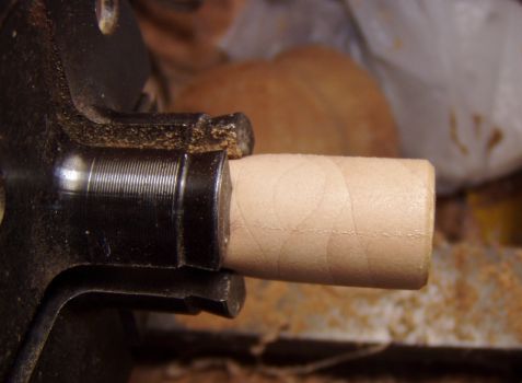

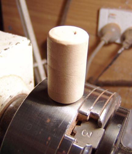

I have been doing my plugs for my casting with wine bottle cork for a long time, now you have those plastic cork and it's much easy to do the plug than a regular cork, just chuck the plastic cork, mark the depth you want have then use the pen tube to cut your plug, part it off and 'VOILA' you got a nice plug who fit nicely the pen tube, BTW take me 30 secondes to do 1 plug:biggrin:

sizeing the depth

cuting free hand
attachment.php
parting off the waste

finished tube with plugs
