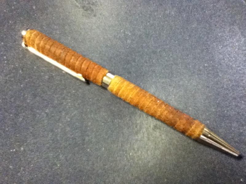

Anthony, this is my current everyday pen - rawhide leather strap wrapped around the tubes, glued with epoxy. Made a little spinning dowel jig to carefully wrap the strip, trying to avoid any glue from seeping thru the seams. No finish on it, just the natural leather - has a great feel! Had to spin it on the lathe to sand the ends to match the hardware OD, but the bulk of it is the natural thickness. Michael's has different colors/styles (like a camo pattern) of rawhide trips, but I haven't tried them yet.
