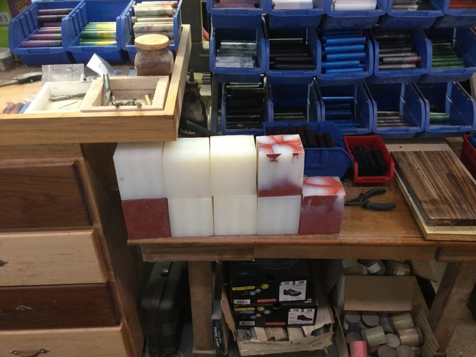

8,173
Eaton Rapids, Michigan, USA.

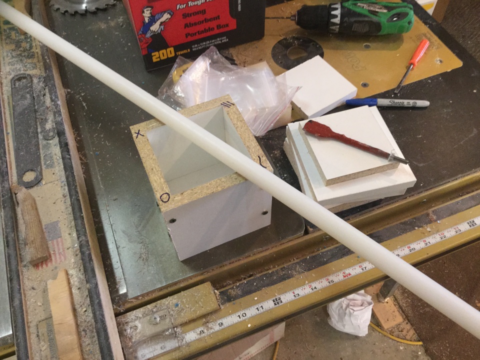

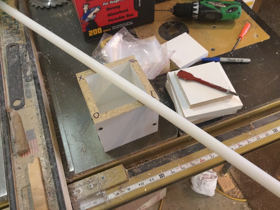

Making the new molds with melamine and delrin. Cheap long lasting materials that are very slick that silicone won't stick to. That red thing is a spade bit that I ground the point off, I use it in my drill to mix silicone.

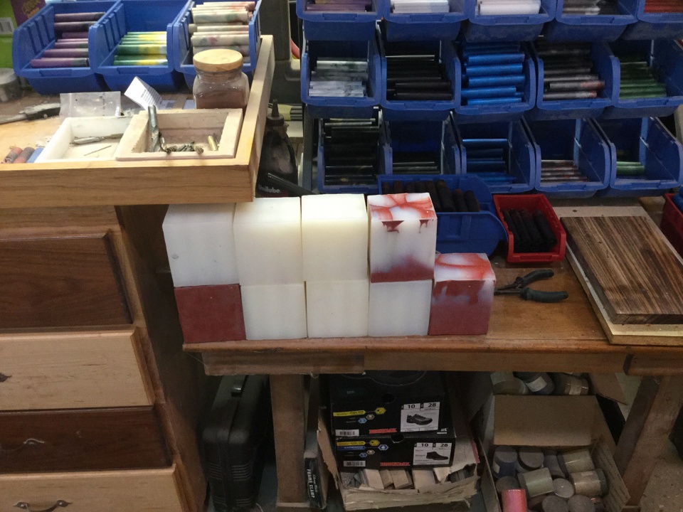

Those rods in the background are basically stage 1 for the rotacrylics. There's several hundred rods there, every one poured by hand. I used up 10 gallons of resin last week just pouring rods only, and there's several more steps the rods must travel through before they make it to packaging. I like to think of it sorta like the tortoise and the hair, because the entire process takes so long you only get a few finished blanks per day, but if you only just keep a steady pace then it accumulates into a nice pile of inventory over a month. The tediousness of making rods and molds has certainly got my attention that it's time to improve things. I actually designed a large aluminum casting mold that would eliminate using silicone altogether and it would last forever, but the machining cost plus materials was almost $2000...doing the math meant it would take about 6 yrs to recover just that cost, so I am just revising and improving the current system which has benefits too. Large aluminum molds and a two ton press....such a sweet dream...oh well :)

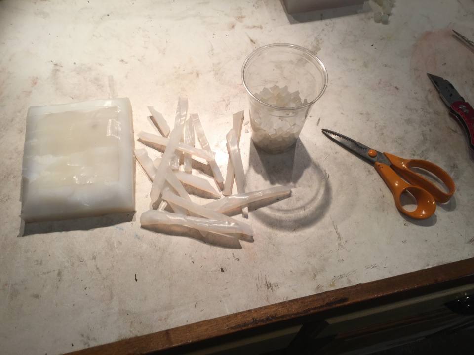

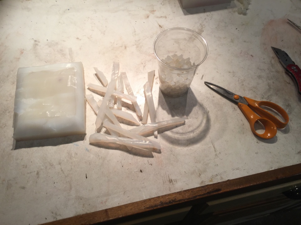

Recycling
I finished the guts in my new mold dies. I always save my old molds. I learned a long time ago that you can re use a good amount of the old molds and it has absolutely no affect on the new molds life span. When a mold dies, really only about 1/4 inch deep all around the cavities is what is dead. Every time you pour resin a little bit of the oil in the silicone is drawn out, thus drying out the mold and destroying it. But all the silicone beyond the obvious dried out areas is completely recycleable. You just need to spend the time to cut those areas off...about 30 minutes time but over several molds it's extremely worthwhile! Do not ever use power tools to cut silicone!!!! Just a sharp knife and scissors...like fileting a fish :biggrin:
Mix your silicone extremely thoroughly in your cups and then pour in some of the silicone pieces and mix it in. I cut mine into strips about 1/4" wide and then use scissors to make 1/4" cups...bit bigger or smaller doesn't matter. When I learned about it, guys where using coffee grinders, but that's alot of work and it's not necessary to create such small pieces for a pen mold. If your doing sculpture molds with a lot of fine details then I bet super small is better.
Combined, my new molds used 58 ounces of silicone plus 10 ounces recycled. The old molds combined where 90 ounces plus 10 recycled ounces...so my rebuilding my masters I saved 30 ounces of silicone plus less time pouring molds.

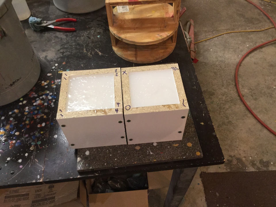

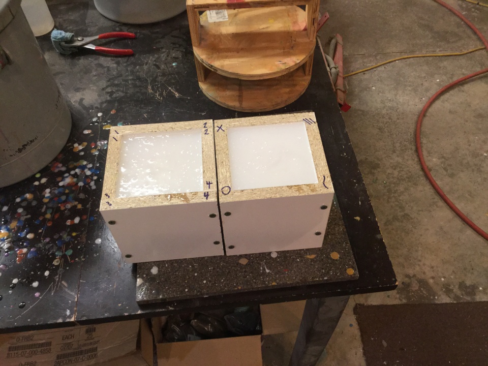

Here's the filled dies. You can't even see the recycled material. All the bubbles are no matter, silicone cures very slow. Air will rise and pressure will crush what's left. Pressure on a mold should be equal to pressure it will be used under. I use 40-45 pounds. I see no reason anything ever needs more pressure than that. If your pouring something that only works out with more pressure then there's a problem...you need to rethink and engineer a solution as to why it needs more pressure because pressure is a very dangerous thing to be working around.

24 hrs is suggested amount of time before demolding but I have found it is much better, especially in the winter when my shop is 65 degrees constant temp, 48 hrs it's should stay in the pot. When removed from the pot i dismantle and remove the silicone right away. It was under pressure, so if it's not under pressure but still in the die it will deform.
