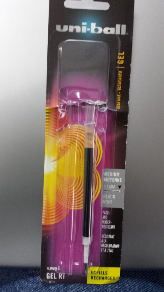

robertkulp
Mar 26, 2014
286
Murfreesboro, TN
Currently using this refill. Should work for any of the rollerball pens. Don't try to put one of these in a Parker refill pen, though. It won't work. Likewise, a Parker refill won't work in a rollerball pen.
