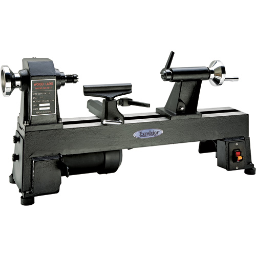

Is this the lathe?
I have this lathe and never got the centers to line up, I gave up trying to turn on a mandrel a long time ago.
I use TBC Bushings, (My own design) and have never had any out of round issues since.
I would suggest you try turning between centers either with bushings or without but you will find it a lot easier (at least I did) and your pens come out better.

I would say at a rough guess that the head stock is out by a degree or two.
Mount a straight dowell in it and see how far out it is at the end about 12"+ long.
Kryn
That would be a good fix if the tail stock didn't have all kinds of slop (at least mine does), there is no sence trying to align the head stock, when the tail stock can move .050" to .060" side to side in the ways (if you can call them ways on a wood lathe).
If it was causing me issues I would remachine the ways/bed and fix the tail stock to line up, but it's not worth the time because it doesn't cause me any issues.

Get hold of a Morse taper reamer in the size of your lathe (not sure if its #1 or #2) and clean it out, as a bit of dirt, sawdust or ding could cause your problem of run out.
Also using a Mandrel Saver will help a lot. If the tailstock is not in line, using a MS might cause early failure of the mandrel as it will flex at one particular spot.
