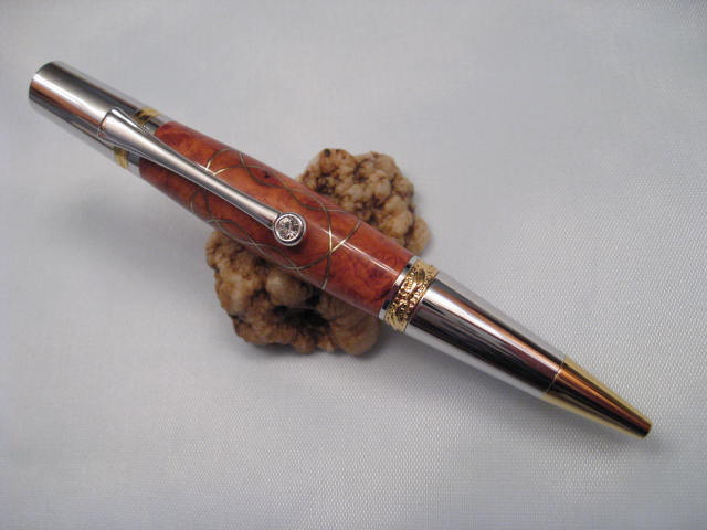

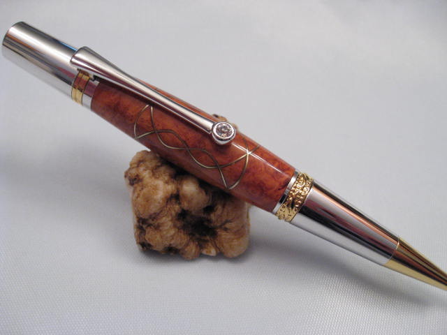

Just made this one for a customer. 22kt/Rhodium, amboyna burl with brass segments. Hope he likes it and also the person he is giving it to for Christmas!
As always, comments welcome.
Happy Holidays to all!

Very nice and the blank goes well with the kit. Just a photo tip. Spin the pen so that the clip is to the top abit so we can see the blank more. We all know what clips look like and so many people do this. It is the blank on the kit we want to see. Just my 2¢

Ok, I've got to ask...The brass design, is that an inlay or is it a design that was put over the finished turn and then CA finish? I've only been turning since September so I'm learning all of these cool little tricks that everyone else already knows. Thanks....AWESOME pen by the way.

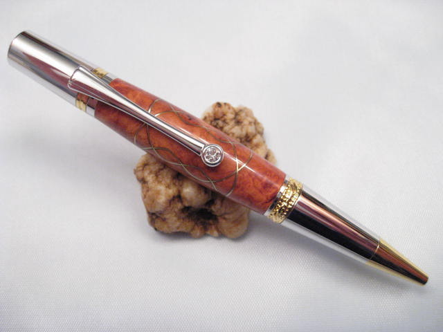

JT - Here's another pic turned a little more.
RW and TW - I make the blanks. These are segmented blanks where each line on the blank gets cut using a jig saw and metal (brass in this case) is glued back in between the two pieces. There is a tutorial here on IAP that describes segmenting metal.

See now we can appreciate the work of art. That is some fine inlay work and it looks very different than what I am used to seeing. I like the pattern. Thanks for showing and thanks for turning the pen.
