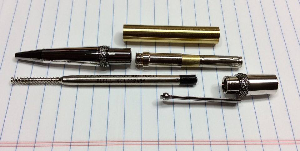

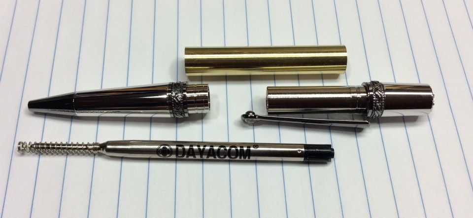

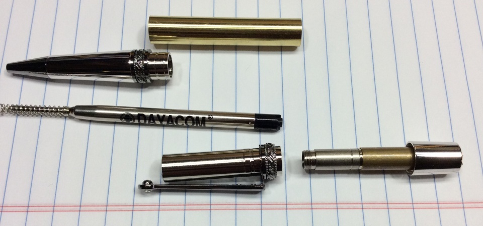

Spanx is correct here. Finial twist for the Le Roi Elegant Major and Barrel twist for the Napoleon. I had just recently ordered some of the Majors but had not gotten to assemble one yet. I checked the tubes with a caliper and they are the same.
Both have the Dayacom stamp on the back of the clip. While both parts press into the tube on the Major, the finial unscrews for ink replacement.
Otherwise, they seem identical in appearance.
First pic is a Napoleon. The second and third pic is the Major.

The nib does not unscrew on neither the Napoloen nor the Elegant Major.
The Napoleon pulls apart in the middle like a Sierra
The finial cap/tranny unscrews on the Major for ink replacement.
See pic in earlier post.
