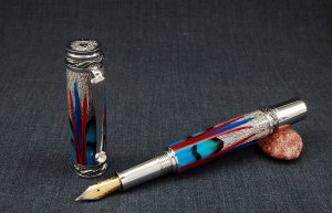

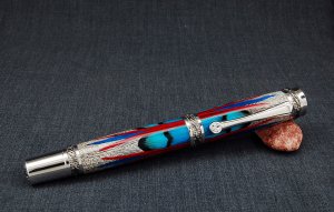

After a dry October, I thought I'd share what I created in the shop today.
Majestic Fountain Pen with dyed Feathers body by Marla's Magic trimmed in Rhodium and Black Titanium Nitride.
Comments welcome about the pen or photos, we're all here to learn!

Mike, yes - three out of four divisions lined up perfectly, so I consider this excellent since she's working with natural materials in making the blanks.
I'll probably upgrade the nib before it's over with as well, but I went ahead and grabbed some photos as it was today when I completed it.
Just for the record this one took some time to finish. I kept noticing radial scratches as I started polishing it up with MM. It took going back to the coarsest MM three times, and working up the set (with only sanding vertically) before I got rid of the radial scratches. I'm pretty happy with the end result.
