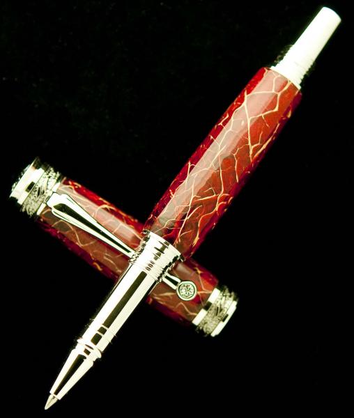

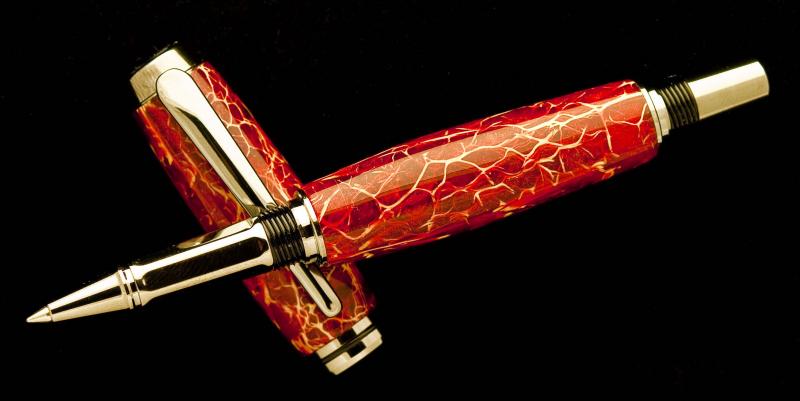

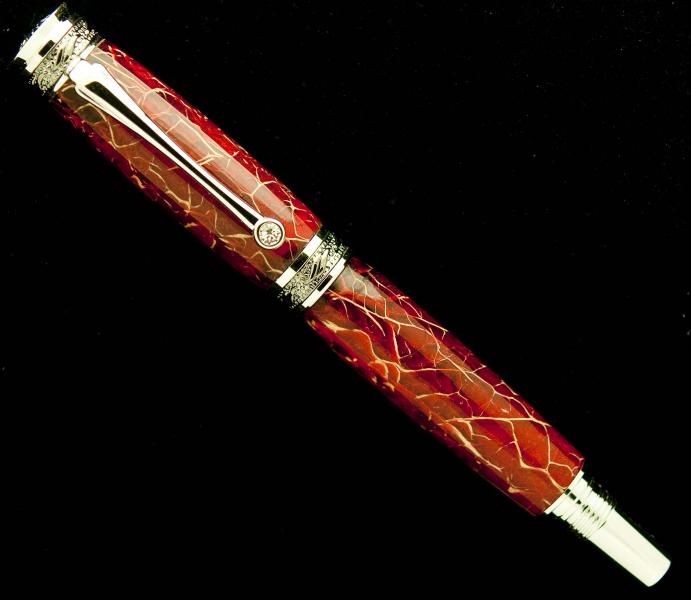

Made it this A.M. It's Curtis Seebeck's "Original Cactus Blank" in Magma Red on a Rhodium and Black T/N plated Majestic Jr. Rollerball.
Reverse painted. Finished with sandpaper to 600 grit, Cleaned with alcohol pad, 2 coats thin CA, 7 coats of medium CA, MM (wet) to 12000 grit followed by HUT Plastic Polish. Comments welcome but most of all thanks for just looking. Doc:)

Beautiful work as always Doc!! Could it be though, that the first picture is just a hair out of focus???? :eek::confused::biggrin: Don't worry with some practice, you'll be able to take some good pictures one day. :biggrin:
David, It is out of focus...I'm slipping:redface:. Will practice some more...got my work cut out for me.. I'm working on "making poop look good":biggrin::wink:. Regards, Doc

All of you know's about blanks from Curtis... I would like to be one of those, who is that guy's?

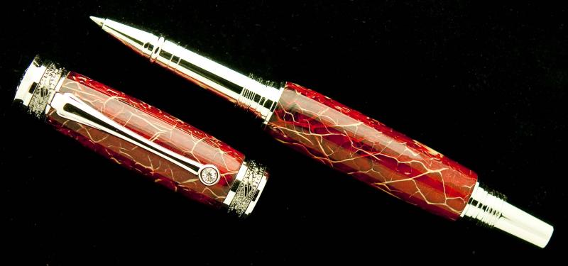

Joao, I did reverse paint the blanks in black and it seems to be showing through in the pictures.:rolleyes: Strangely, in person, you can't see that looking at the pen. The only thing I can think of was the light from the flash penetrated the resin and brought out the black. The last Magma Red Cactus I did, I reverse painted red and the color of the blank seemed to change. (see attached pic). Next time, I think I will mix a color that looks as close to the blank as possible.
Regards, Doc

Nice looking pen, Doc! Personally, I prefer to reverse paint with black on the Magma Red blanks just like you did. It gives it a more "Magma" look and gives more depth.
