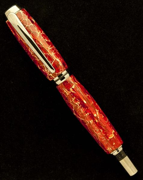

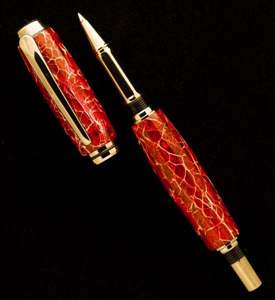

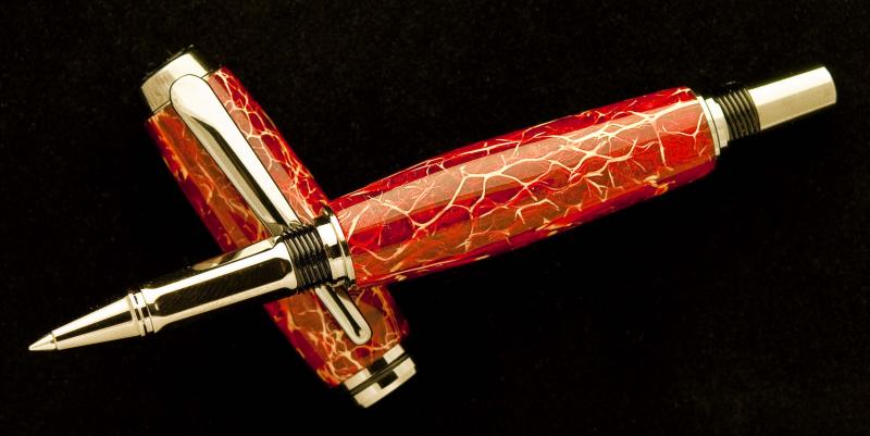

Made this early this morning. It's Curtis Seebeck's Magma Red "Original Cactus Blank" from on a Black Titanium Navigator Rollerball. Hope you enjoy looking as much as I did making it. Have a great day. Doc:)

Same here. I have one that I've put off turning for some reason.
It looks great! Do these need a CA finish, or just sand and buff?
wizard
Aug 27, 2009
3,569
Houston, Texas
Joe, I did a CA finish. Sanded from 150 to 600 grit. Went ahead with 6 coats of CA (medium) and MM from 1500 to 12000 followed by HUT plastic polish.
I didn't head the sand and buff route so to answer to your question, I'm not sure.
OKLAHOMAN
May 17, 2006
10,228
Costa Rica
Doc, great job!!!! Cactus pens are some of my best sellers....and yes after talking to Curtis a CA finish is the way to go.
