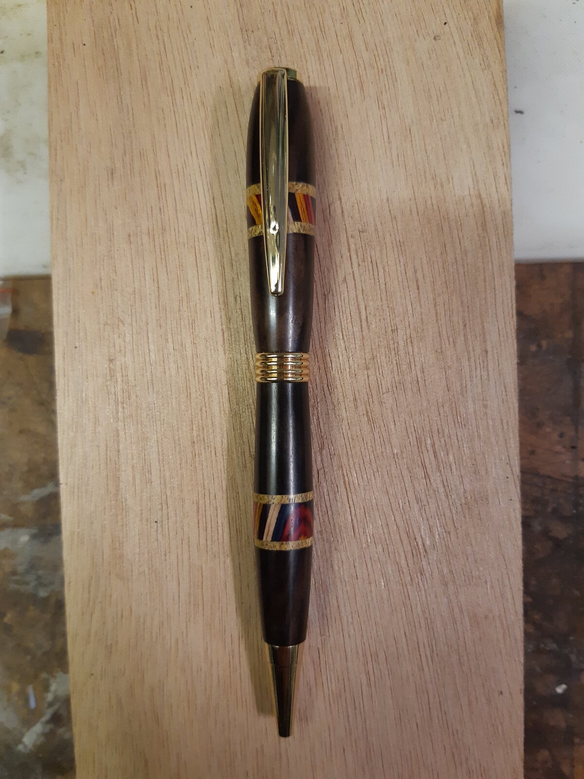

Quite pleased with this one just a bit different.

magpens
Feb 2, 2011
15,911
Canada
Beautiful pen !!!
I love those attractive ornamental bands on both the bottom and the top barrel !!!
Each ornamental band has 3 rings. . I want to ask about the middle ring of each barrel.
Is each middle ring made from multiple different woods ? . The colors would suggest that.
Very well done !!!

Kcimdrib
Nov 1, 2020
1,378
UK
Beautiful pen !!!
Very well done !!!
I used a puchased made up blank left over from a recent pen see photo just cut small segments sandwiched between light woods. The rest is Ebony.
Hope this helps.

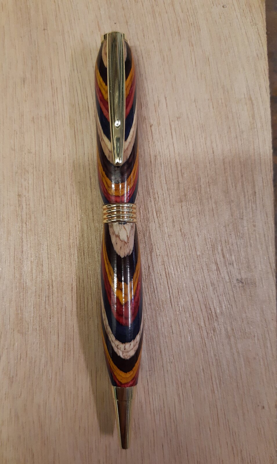

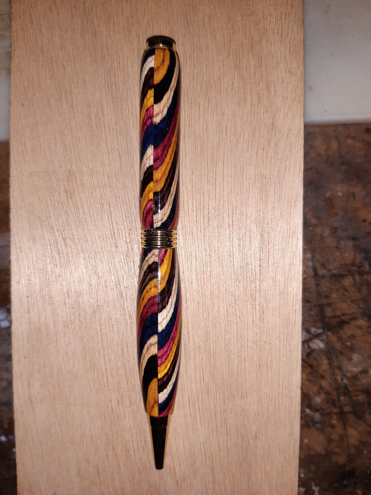

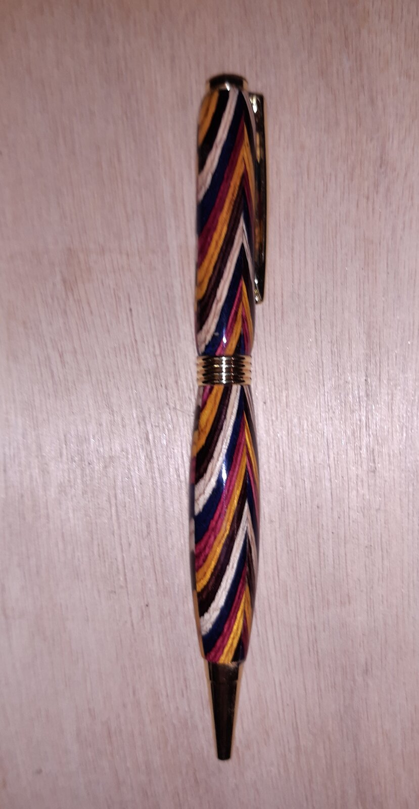

Kcimdrib
Nov 1, 2020
1,378
UK
Nice looking! Like the bands! It just takes a little practice with the CA. Another thing, don't know how your winter is right now but unless your shop is very warm, that CA will probably be a mess. I changed to CA my first winter when I found my wipe-on poly wasn't curing. Heat lamps and a propane heater helped the CA and I've been stuck ever since. Lol
There have been a few threads over the years where this is discussed. Do you finish it? Set it aside? Try another finish? While not summarized exactly like this, most everyone has had the blank finish from he_ _! A dozen finished perfect or close to it, then there is the one pen that no matter how many times a finish is tried, even over a few weeks, it still turns out bad. Set it aside and try it next year! "Sometimes" that helps! :rolleyes:
Tried CA finish again today today slowed the Lathe to 500 rpm gave it 5 coates and finished with Burnishing Creame.
bsshog40
Oct 2, 2018
2,391
Omaha, Tx
Looks good. Yea slow speeds are best for CA and letting it dry. If you coat too fast, at least from what I have had, the new layer takes forever to dry. I wind up having to accelerate then.
