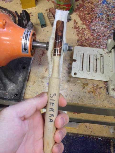

Any general tips on buffing? I'm ashamed to admit that I ruined my first pen while trying to buff it. I'm more ashamed to admit how it happened.. The buffing wheel yanked it right out of my hand and bounced it off the floor, completely smashing the brass tube. You live you learn. I'm wondering what you all sand the finish with before buffing and what kind of buffing compounds you use. My buffing wheel came with Tripoli, diamond white and some kind of wax. I'm not sure if I loaded enough of that stuff in the wheels though, etc.

I have an extra mandrel that I drop the pen barrel down over when it's time to buff. It butts up against the brass screw at the bottom and the rotation of the buffing wheel keeps it butted up against it. Since I have both hands on the mandrel, a catch won't heave the piece across the shop.
ETA: Anything like this will work: an old screwdriver, a dowel rod with a handle attached, etc.
Great minds think alike. A picture says 1000 words, I went out to the shop and snapped a picture of how I do it (except for hand position - I did that to show everything).
I took some 3/4" dowel rod - chuck it up on the lathe and turn the end down to where a pen blank slides on and then gets stuck. (Marked each for the type of kit).
Then if you hold it against the top of he wheel, it pushes at you and has no-where to go to fly around the room. Caution is still needed to not do something silly, but it is much more controllable than other methods I've used.
