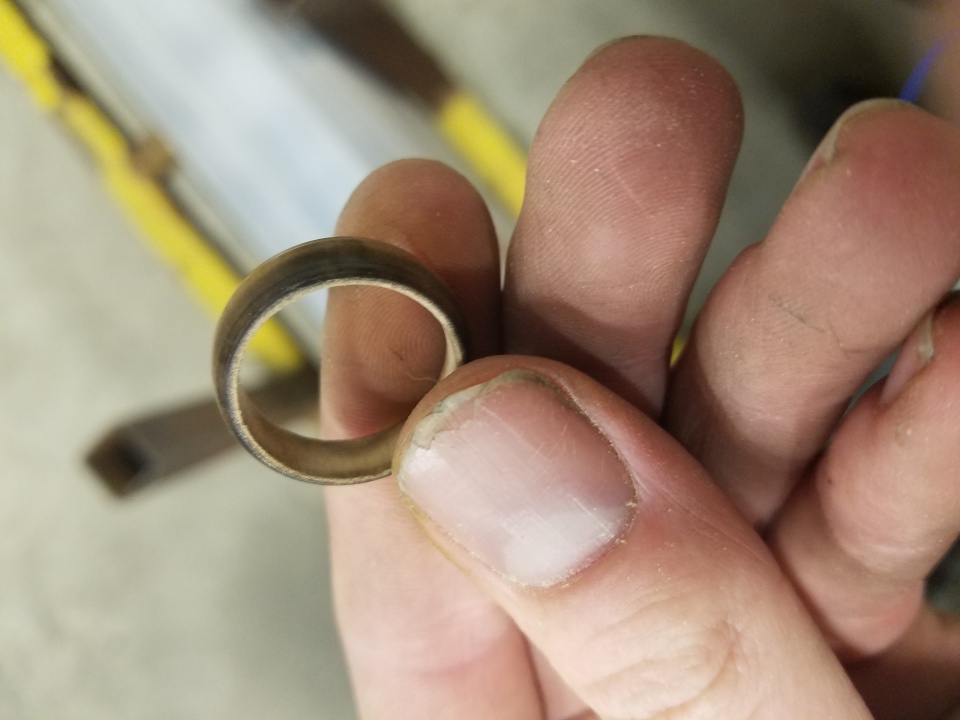

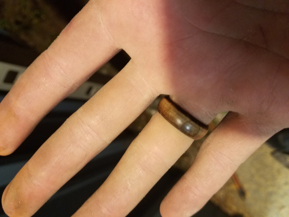

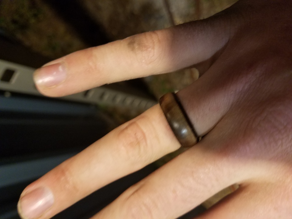

While I'm waiting for the next batch of supplies to come in, I wanted to try something a little different.
So I watched a tutorial on making rings and decided to take a shot. Little more difficult without a chuck.
It was much more difficult than I thought.
Most of what I use is pine left over from work.
Started out large and worked my way smaller. Once I got to where I got the size right, they let breaking when I tried to clean them up.
Finally ended up with this:

Create your own jamb chuck (mandrel) ...
Turn a tapered piece of wood (any random hardwood) ... make sure that somewhere around the middle is the size you want for your ring. A piece of tape wrapped around the spindle may help to keep the ring secure without breaking it.
Use one of the spare faceplates that came with your lathe, and mount a block of wood in it to secure your taper. The faceplace will ensure that every time you mount it on the lathe, it'll be square and true. While gluing the taper into a hole in the block, make certain that the other end of the taper is secured by the tailstock ... rotate the lathe by hand before the glue sets, to ensure it'll run true.
Now, after you take your chosen material for the ring, you can drill a hole of the appropriate size and mount it on the tapered mandrel. From there, you should be able to turn and finish it normally, though you may want to have a dremel or other small rotary tool on hand to work on the inside of the ring.
Alternative to that, you can take another smaller taper or a series of them, and glue various grits of sandpaper to them (wrap in a spiral) and sand the interiors of the ring by hand or by mounting the small tapers in a lathe chuck.
