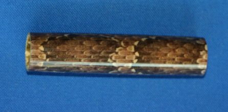

Using my technique of sizing in photoshop and/or powerpoint I cropped a section, printed a few of them on computer label stock, wrapped them around some sierra tubes, and used the technique Don describes in his snake skin tutorial to cast clear resin around them. If you save this picture, you should be able to duplicate the process and we thought it would be great for any who wants some practice casting before they use expensive snake. If that doesn't work, send me a pm and I will send you the original file Don sent to me. Please steal shamelessly.

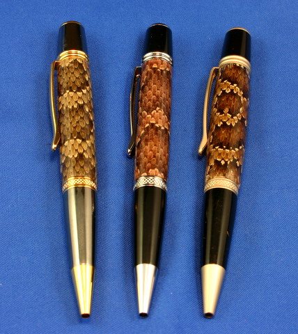

As a thank you to Don, I sent him a couple and here's what he turned:
Is it real or is it memorex?
Hopefully we can twist Don's arm (shouldn't be too hard) to make and photograph the real deal for comparison.

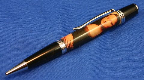

Here is a picture of the blank Bruce sent me of the faux snake skin assembled into a pen. I think it looks really close to the real thing. A little of the actual look is lost in photographing and posting but I think the photo shows just how close it is to the real thing...skin, not Coca Cola. Bruce did a great job with the blank...from the photoshop work to the casting. His blank is the first one I've seen using my tutorial and it's nice to know that my instructional tutorial articles(at least the snake casting one) seem to be straightforward enough to follow. I often wonder how others find them. Bruce did a great job. I also know he is trying to make the printed skin look even better both color-wise and texture-wise. I would bet we see an improved version soon. There seems to be some interest in this technique. Bruce also sent me one of his blanks with Mona Lisa under the resin. I include a picture of that pen also. Oh yea, the faux snake is the ???? pen. Thanks Bruce. Only the turning of these two pens is mine. The rest is the work of Bruce.

We did this experiment for those who wanted an alternative to practicing on real skins...although, it looks pretty darn good. Had a color shift but Bruce is working on "photoshopping" a better image.
