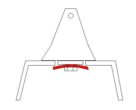

I'm not familiar with that specific lathe but could it be that the nut/plate under the ways has been overtightened and is now bent upwards so that it clamps against the bottom of the tailstock body before ( or more ) than it clamps against the bottom of the ways?
Can it be turned over? Perhaps the square block that travels between the ways ( whether it be part of the nut or part of the TS ) can be draw filed flat again?
Edit; Here's an exaggerated sketch of what I mean

It really has nothing to do with the lock down mechanism. It works fine. Nice and tight and no creep. Because there is slop between the base of the tailstock and the rail on either side you can't be sure the tailstock locks down perfectly aligned with the headstock. It can be off as much as an 1/8" in either direction.
