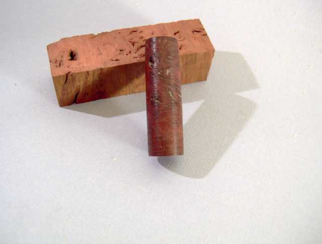

i`m looking for any info and know how on using glitter,embossing powder and such products for these Jarrah blanks i have..I rough turned one to see how it is,they turn good and stay together,anything you can say
on subject will be helpful.. Carl

You could use the wood dust itself by turning it then filling the voids with CA and then using 220 grit paper on it as it spins. I do this all the time.

I turned a couple of pens with jarrah and they turned out great. I filled the voids with CA until completely full and completed the projects with a good CA finish. have heard nothing but good comments on the two pens. I will get pictures and post them soon.

I do both of the above mentioned methods or we have a variety of ground stone and brass. I fill the voids with the powder then let thin CA run into the void to fill it up. Sometimes if you put the CA straight on the filling it will run out of the void, so let it wick in.
