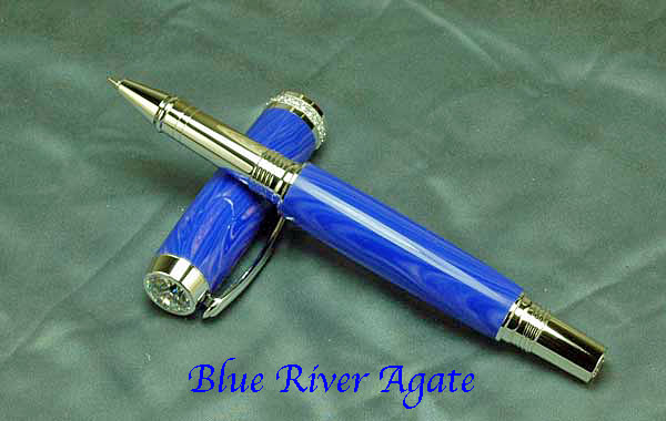

I have seen this blue material on very high end pens before and ran across a photo of it again and was wondering does any one know of any place to get material like this??? I have no idea if it is an acrylic or a stone or what. I love the color and grain pattern of the whites running throu it. It is not a homemade product. Thanks.

This photo makes this appear to be blue swirl bakelite. Ed4Copies has a very nice selection of bakelite and those are usually y first pens sold at shows.

Looking at the picture it appears the material is not very translucent. I can't tell whether its got "swirly white" or "swirly pearl"---that would help identify.
So, if you can answer those questions, I may be able to help you locate.

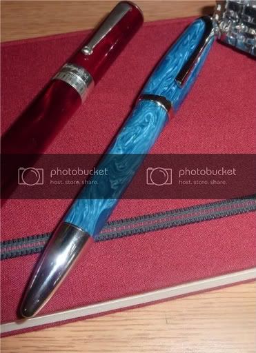

I know it is not translucent. I know it is not a pearl. I do know some famous pen maker company uses it but I can not remember the name. I had seen it in a pen store and do know the price was quite high. At that time I was looking at it the color was esquisit and that is what caught my eye. I should have paid more attention to what the guy in the store was telling me.:)The one in the photo is probably one of this manufactorers pens because it is the same look. I think it might be a stone. I don't believe a famous pen company would be using acrylics. I will have to do some digging to get some more info.

http://www.marcuslink.com/pens/compa...ppa-visit.html
Andrew ,really enjoyed reading this and as I always said "Viva Italian Pen Makers"..
Ed, how'd you like to have that much celluloid?
Roy,
I enjoyed the read partly BECAUSE I have always thought I could find the source for the celluloid used by these "high-end penmakers". It is comforting to know they make it themselves---that's why I can't FIND it!!!
Although we COULD have an acrylic made to our specs that would look just like these pens, I doubt anyone here would pay for them. Minimum order is about 500 blanks.
Anybody wants to take half, PM me.
