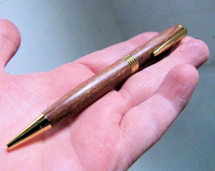

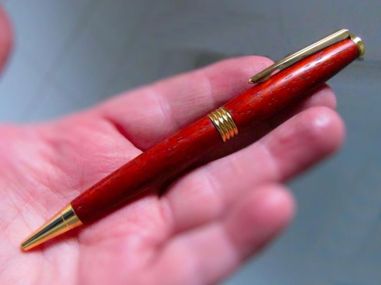

The critique is not of the "simple" pen but I am wondering about the structure of the photograph. My thoughts are to show the pen in the hand of the artist to give it perspective size and a warm human feel. I created a focal point of just the pen and blurred the rest. What do you see and a negative or a positive?

I struggle with photographing pens - both composition and mechanics; so I won't comment on the pics. But it reminds me of a member here who used to post pictures of Retro rollerballs held in his hand (haven't seen him post in a bit, but I think it was within the last year). He would blurr out the hand so it didn't distract from the pen. I am imagining that was done on Photoshop.

Umm, I'm sorry to be negative, but compositionally, these pictures don't speak to me. I think if you want to use a hand as a prop, it should be writing with the pen. Just cupping the pen in the palm doesn't tie it to the hand thematically. Also, the perspective seems too close. It appears as if you're holding the pen about 1 foot from the camera. The photo would look more natural if shot from 2 feet away.
Although selective focus is a useful tool for emphasizing the subject, too much blur in the same focal plane can look unnatural. In this case, I think you've overdone it. Remember that a good photoshop job shouldn't look like a photoshop job.
More importantly, that is simply and solely my opinion. If you (or more importantly, your customer) like(s) the look, then stick with it.
Most importantly, you're working to improve. Keep trying. Experiment with different poses and different lighting - and your photos will get better.

Sorry, but I too must say that the use of the hands is distracting, and the out-of-focus part just bothers my eye. It prevents me from focusing on what you want me to see, which is the pen. It doesn't work for me.

I'm not for the hands either. Eric pretty much summed up what I was thinking as I looked at them. I also think the color (white balance) on each is off as every photo has differing levels of too much red/pink/magenta in them.
Stepping back to take in the overall view of the pen writing would come closer to working. I think if the hand was holding the pen in a more natural writing position it might look better, even going so far as to pose it on a journal with writing in it.
Keep experimenting and trying various ideas and let us see what you come up with. Asking for opinions is a sign you're looking to improve and we'd love to help you with that!

Depending on the sophistication level of your software, you might keep the pen in color and bring the rest of the photo to monochrome. Keep the hand in focus, just grey.
The pen will then "pop" (I hope).

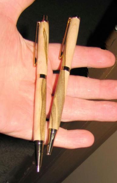

No Hands !!!! A suggestion . . . purchase a jointed/moveable wooden hand used by artists (Amazon or Ebay, etc.) and buy a pair of white or colored female gloves. Put the hand into the glove and you can pose it to hold/accommodate any pen. I also bought some museum putty to help hold the pen if needed without damaging the finish. White glove makes any pen really pop but subtle color(s) also add a really nice accent. Again, just a suggestion.

How about both?
I'm in the "no hands" boat. But I understand why you want to show a pen in a hand for sizing sake.
How about a "regular" pen shot with a small "pen in hand" inset in one of the corners of the overall shot. That would show the pen and how it fits in the hand.

I don't think that hands necessarily provide any perspective of size because you have no idea how big the hands are. If you want to provide perspective for size you need to include something that is standardized and consistent.
I also agree that the hands detract from the overall feel of the picture and draw the eye away from the pen. This is why so many of the pen pictures are of just the pen. Anything else can tend to draw attention away from the subject which is the pen.

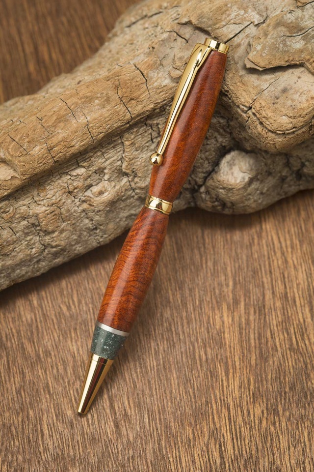

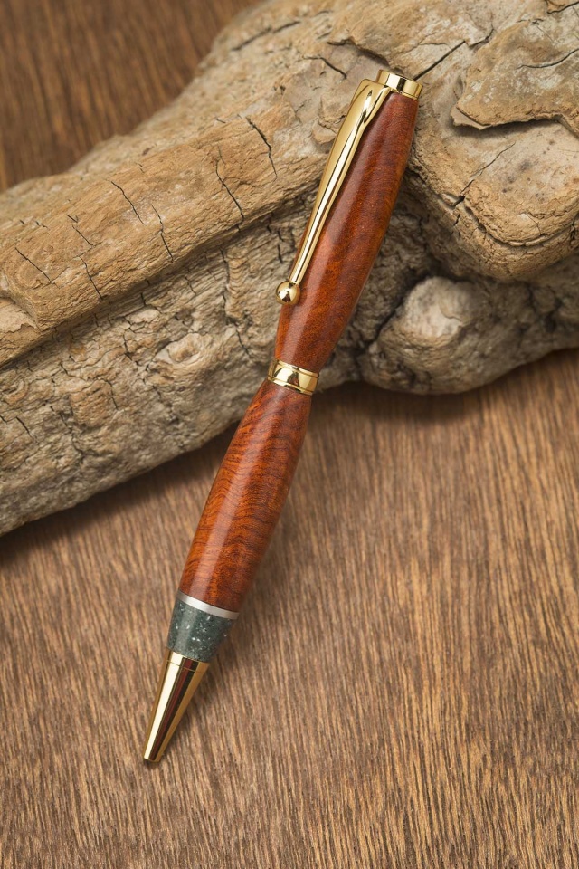

I would suggest using another prop besides the hand. Your skin is white, and your eye tends to go to the hand rather than the pen. If you want to show scale use another object to show that scale. I do think that most people know what size a pen is, so that may not be necessary.
I often use a piece of driftwood, or rough wood for contrast as the pen usually is very smooth and shiny.

I'm not a fan of props of any kind in pen pictures. (just my opinion). Props tend to draw attention away from the pen. I find myself inspecting the prop. Same goes (for me, at least) for patterned backgrounds…distracting. Also, pen pictures should have the pen fill the frame. A pen image 2 inches long in the center of an 8x10 canvas does little to show the pen. Good luck with your pen pictures.
