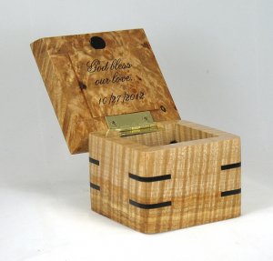

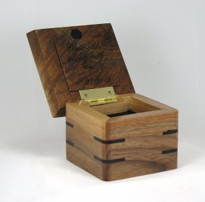

I actually completed the boxes a week or so ago. I made my own insert using some stiff foam, and velour cloth I got from the craft store. Here are photos of the boxes. The customer loved them. If I had more time before deliver, I would have sourced antique brass hinges.
