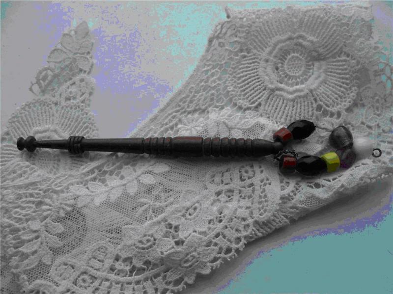

I have a customer looking for me to make a Statesman FP with Irish Bog Oak. I have not been able to find anything but Irish Bog Oak/Lace Bobbin??!! I have never worked Irish Bog, so I want to make sure I get the real stuff. What is Lace Bobbin? Can anyone lead me to the real Irish Bog Oak? Anything I need to know about working it?? How expensive is the good/real stuff?
Help is appreciated. Thanks
Here's an auction on e-bay 290301503055.....I've bought several items from him just recently......shipped it from the UK on Monday and I had it in California on Thursday! Also, you need to know what size of blank you need in 'Metric'.........
Here's a lace bobbin: newly made by a fellow in the UK.
Here's a lace bobbin c1850: see attach
Lace bobbins are used in hand made lace.

Dave is a good source, I bought from him many times before finding my current suppliers. Only issue is the blanks often go for $10+ on ebay (I know as I usually watch them and make sure that they go high or come to me :biggrin: I can never have too much Bog Oak).
