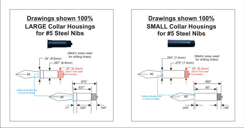

See if this helps you any. It doesnt seem to be what your looking for though.
Timebandit
Sep 25, 2010
1,446
Austin,TX
Those were sent to me as the #5 nib size for Brians feeds.
They kind of look like his, but the first one looks like his #6 feeds. I have a bunch of both #5 and #6 of his and the #6 look like the first picture and the #5 look like the second picture. But there arent and thread sizes on there:frown:

I have his website on another page and some of his number 5 feeds look like a courser thread count guestimate would be .75.

Can you put a digital caliper on the thread diameter you need and tell me what size it is?
mredburn
IAP Activities Manager
Staff member
Jul 5, 2009
8,753
Fort Myers FL
That would suggest the threads are m6.5x.75. The plastic threads are a little sloppy and you could use m6.4 x .75 as well. They will not be available through normal tap supply. They will have to be special order. If I can get a hold of one I can measure the thread pitch for sure. It would not be a problem to special order them a dozen at time once I can verify the thread pitch.
