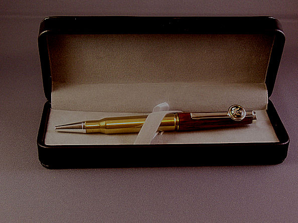

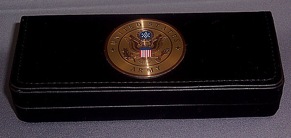

Army Idea for pen

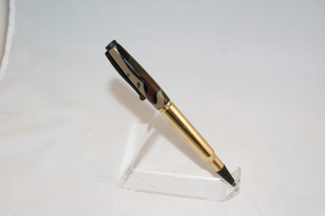

This is a 30.06 powder coated shell, Cocobolo top and a Army logo clip from Hut.
Box from PSI and the 2" logo on the box is from a local supplier
Thanks for looking

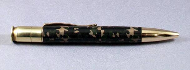

Something like the ones on the two ends do? Ed4copies has urban, jungle and desert camo resins. Easy to turn.
Send him a PM through the forum and ask for his "cat-alog".

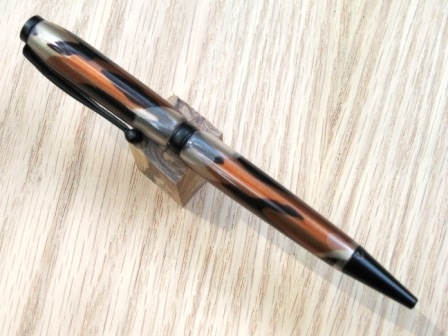

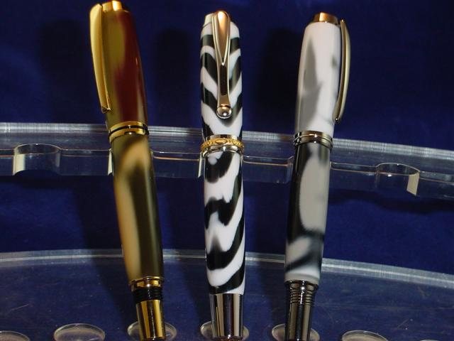

This may not be exactly what you are looking for, but I made this pen from an old style blank and it looks "camo ish".....Elliott Landes had some of this for sale a while back.

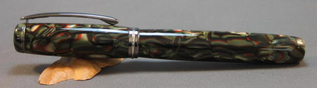

Here's one I made for a Retired LTC. It's an acrylic "Hunter Green" blank from Woodcraft with the twist cap fountain pen. I added the finial Army logo from Hut....Sorry about the lousy photo...

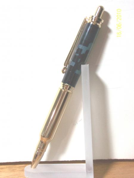

Camo pen.
I got some Navy camo and cast it. The color changes when wet, thats the only down side. Next time I will try to water proof it first.
