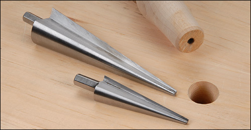

I use the "plugger" bit from Lee Valley. It cuts a tapered hole just the same angle as a pencil sharpener sharpens a pencil, which happens to be the same angle as a standard ballpoint pen point. You can drill the hole directly into the wood and the pen will fit securely in th hole. If you drill it deeper, it gets larger in diameter which accomodates the larger pens.
I cut a slot in a block of wood to hold business cards, then turn it and drill a hole with the plugger bit to hold the pen. You can make it as simple or fancy as you want. You don't have to turn it, you can make it rectangular or square, or any shape you want, with more than one pen hole, and a brass plaque, if you like. I have made them with turquoise inlays.
This one? (seen here http://www.leevalley.com/en/wood/page.aspx?p=54864&cat=1,180,42240,53317,54864)
Me too. The smaller of the two will ream a tapered hole up to 3/4" diameter at the top -- more than enough for any of the kits I use...

Nope.....looks like this is what she's referring to:
Be sure to start the hole with a 1/8" bit.....
http://www.leevalley.com/en/garden/page.aspx?p=10254&cat=2,42706,40719

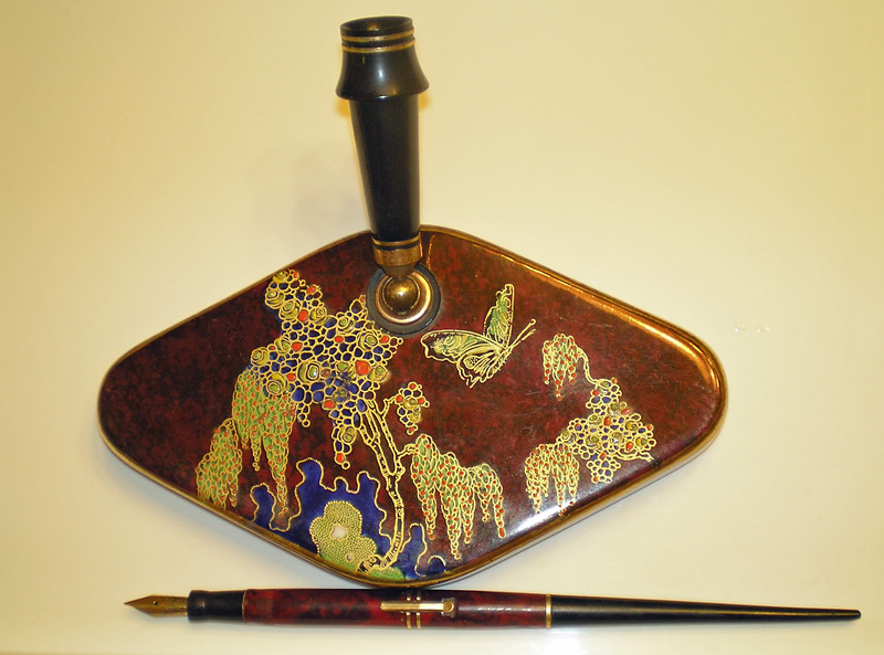

Sure wish someone was still making the large ball and socket type joints like this one from Wahl Eversharp.
Dan
