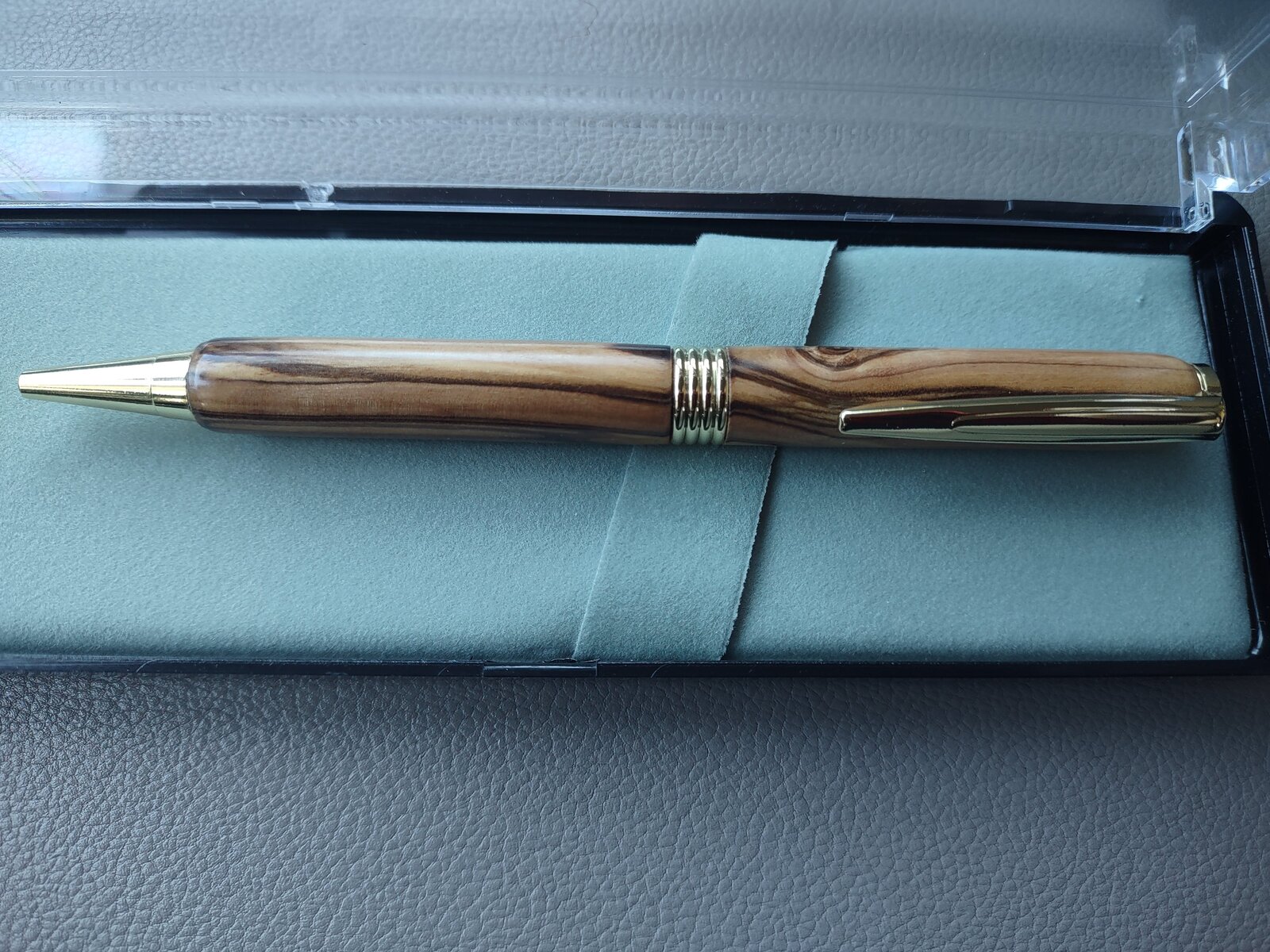

I also have Odie's Oil and Wax, which I've used on tables, and it's nice, but I've not heard of people using it on pens. Any thoughts on whether using wax is necessary on Aussie Oil, and or it would cause the pens to look worse in the long term? I imagine most of the pens I make will end up with family and people who don't do any maintenance on them.
