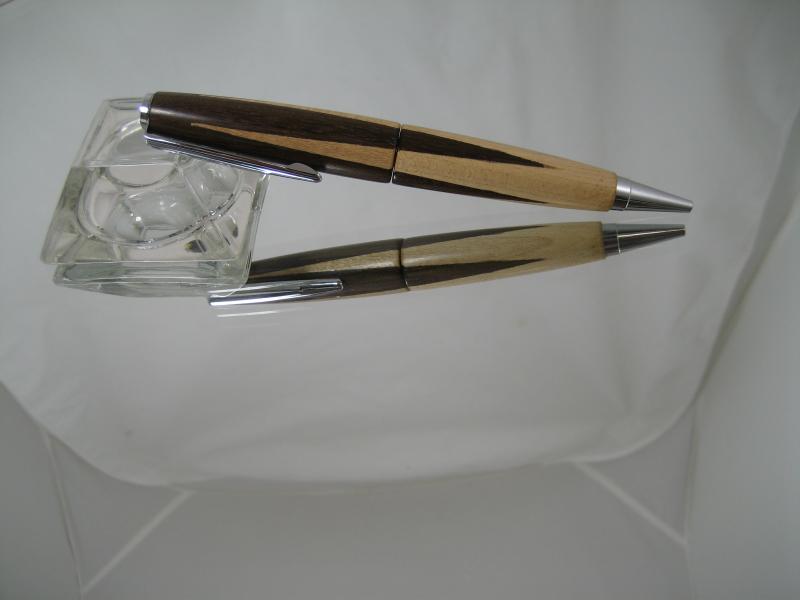

Here is one from some time back. The kit is a basic 7mm and the pool cue was very old. I've always thought that it is a little too thick in the middle. Some of the newer low end pool ques are just stained two colors, but this was two separate types of wood. The light wood was maple and the dark was wenge. Out of the entire pool que there was only this one spot where the two types of wood came together. It looks like the maple is way underturned at the nib, I don't remember it looking quite that bad. The old wenge made wenge on the butt end made some nice pens. I've got a couple more of these cues and I'd like to find something better to do with them.
