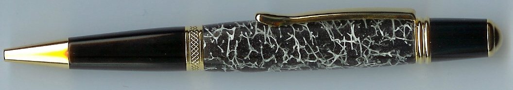

firet cast sorry pic bad could not get it to shine any help on getting it to shine i think it turned out ok

How are you finishing it? That would be good start for anyone to try helping. This stuff should polish like glass. The pen looks good though.

Did you paint the tubes or is the resin colored?
It looks almost like bubbles.
I'd say that anything that's been cast, like a sponge, that you have to actually cut the material while turning it, you need to finish that off with a coat of CA. If not, they'll be both resin and material at surface level.

Both/either a pressure pot or vacuum will help with those bubbles. I know, easier said than done.

I've done one cactus blank and what I did was sand it to polish it with MM all the way to 12000. Then I applied 2 coats of thin CA and when through the MM again to 12000. Then, the next day, I buffed it with White Diamond.

I am guessing the loofa goes to the surface.
I would build up with CA and finish.
The same situation occurs when I lamiate metal or wood in my plexiglass blanks.
