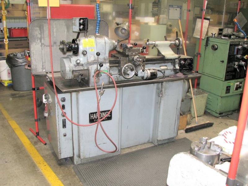

The package I want includes a 4" 4-independent-jaw chuck, a bench to bolt the lathe down onto, a quick-change tool post and tool holders, a tool rest that fits into the QC tool post, and insert-type tooling. Later I'll see about a collet system for the beastie.
I'm still spoiled from years of working with a Hardinge toolroom lathe:
