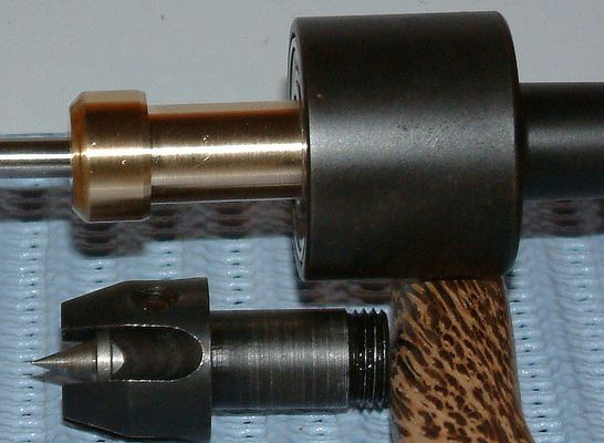

PenPal
Nov 29, 2006
2,708
Canberra, A.C.T., Australia.
Live Centre Cure
My method has been used by me now for years.
Pic shows live centre with a removable centre under.
A brass sleeve before insertion with a snug fit 3/8 inch deep hole with the mandrel end in it.
No more problems this unit in use for years for Slimlines.
Rgards Peter.
