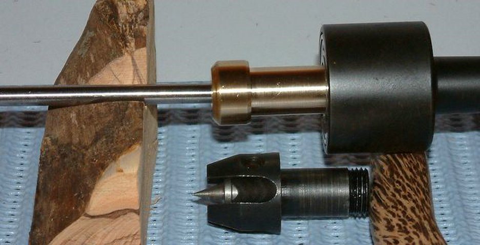

A perrenial discussion brings every ones solutions over again so this is my solution. Choosing not to use the point of a live centre in the end of a mandrel.The pic shows the live centre mod with a brass sleeve with a snug fit 3/8 inch deep to receive the mandrel.
The brass sleeve before it was pressed into the live centre showing the removed section. No more problems.
Take care Peter
