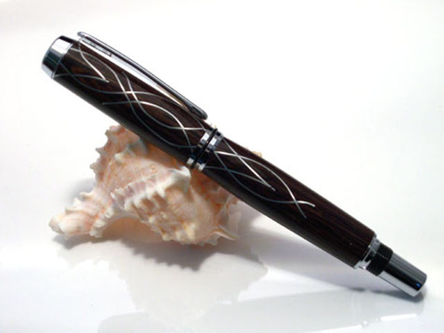

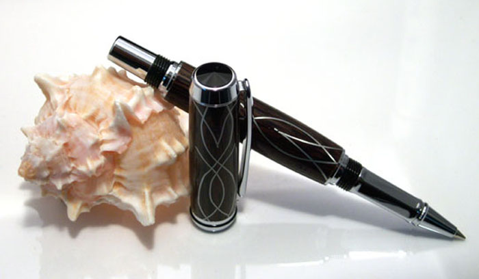

My cousin Mark is a very Business/Professional type. So, I thought it only fitting to make him a pen. Now, he is the only cousin in AZ that is getting a pen so Shhhhhhhhhhhhhhhhhh!!!!:tongue: This is a Platinum Navigator with Wenge and Aluminum. CA finish. Still developing those scroll saw skills, as you can see I have a way to go. Something to strive for come the new year.
Chris, I know you're watching, is that title alright???:smile-big:
Thank you for looking. I welcome and appreciate all comments.

Ouch! That was a gotcha, Chris.
Very nice pen, Steve. Mark will be proud to carry it and prouder yet to use it. If I only had a cousin that thoughtful . . . . .

Your scrolling is coming along nicely Steve. I like that design.
Some comments. The Navigator (Baron) has a two start thread, if you put the design on the other side of the blank as well, it will line up regardless of which thread you start on when capping the pen.
I also think that design would lend itself to a closed end pen. As it is, I think the design would look off when the pen is capped, by making a closed end pen you take away that option.
